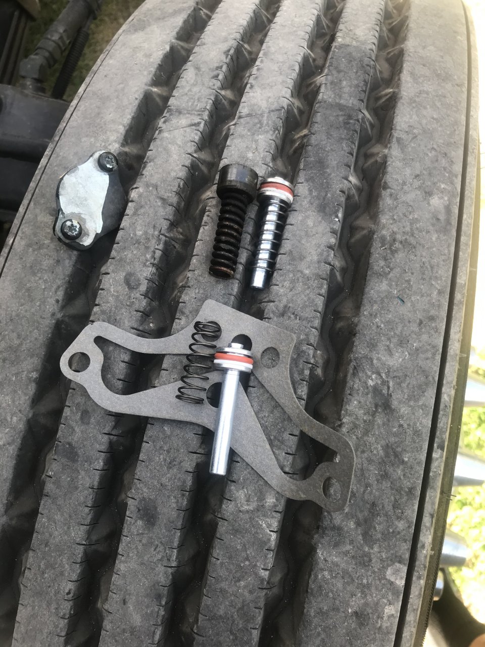

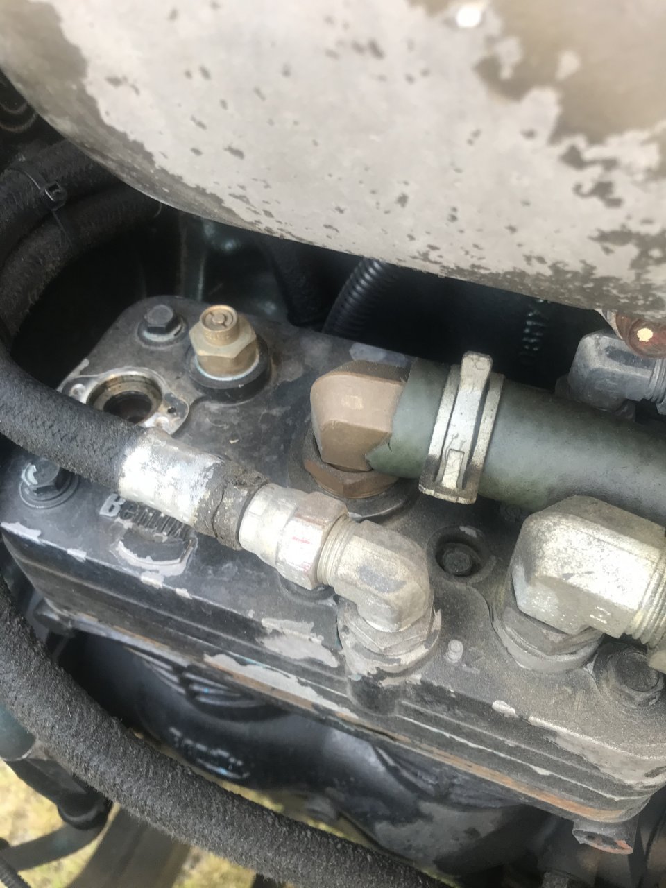

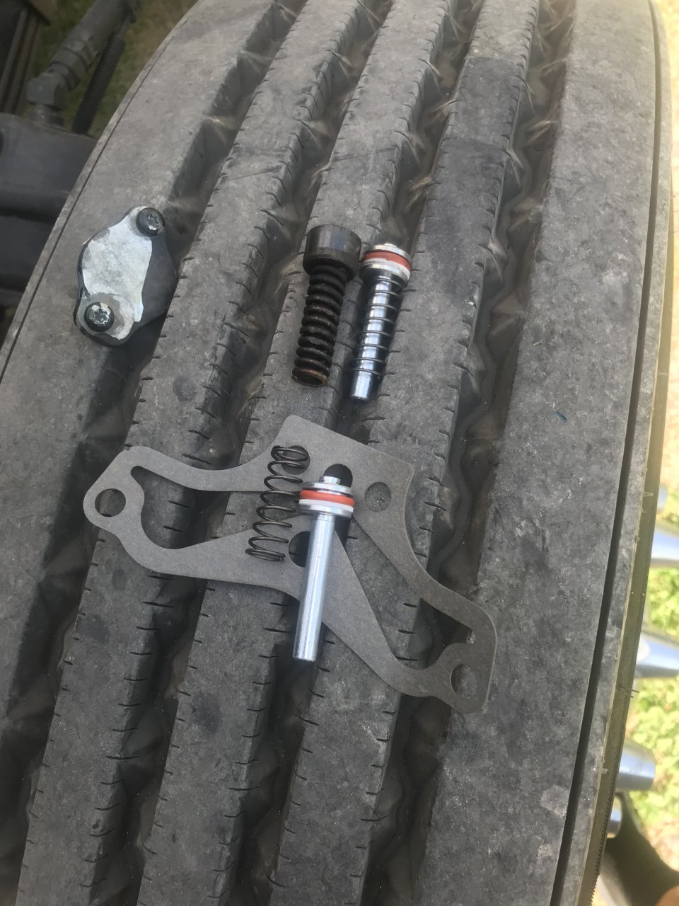

    Ok I FINALLY tried to change the unloaded valves on the air compressor today.... I’m thinking they gave me the wrong kit for the wrong kind of compressor.... here are some pictures.....

    Those look like the 550 unloader valves
    nikmirbre Thanks this.

    That gasket that is laying on the tire under that spring.... doesn’t go anywhere I can see.....that gasket came with that fresh spring and that bolt thing with the rubber seal on it. Only thing bad about a glider is I gotta know part numbers or at least exactly what specific part I’m looking for....

    Based on picture of compressor.... build sheet says it’s a BA922. Could that be what I have?

    That’s what @spsauerland said it was a couple pages back. I never had one of those, but google showed a unloader valve like you pulled out for a ba922

    yes, I for some reason missed that post. Thank you. Now that I see its easy I’m gonna go exchange tomorrow...

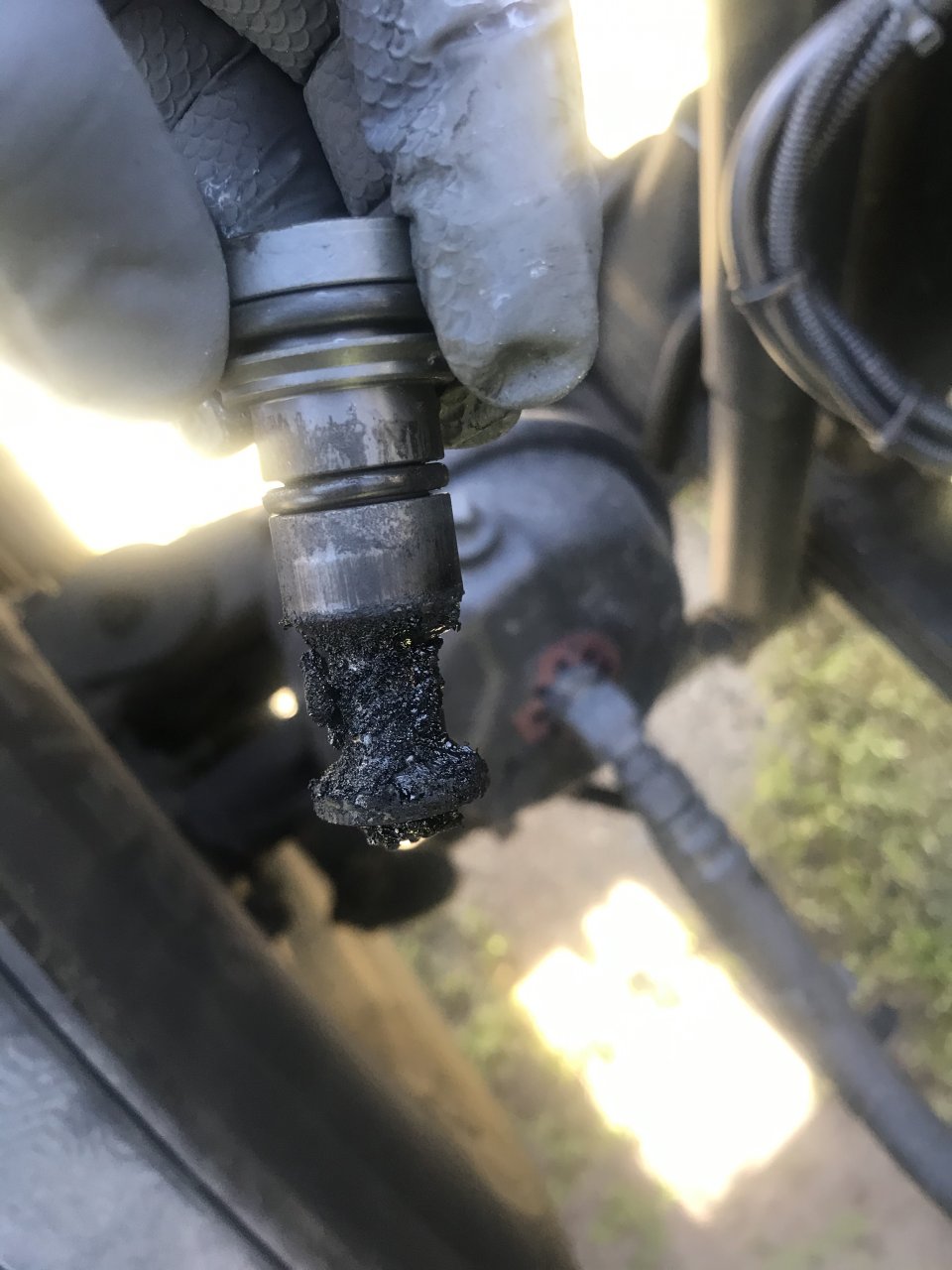

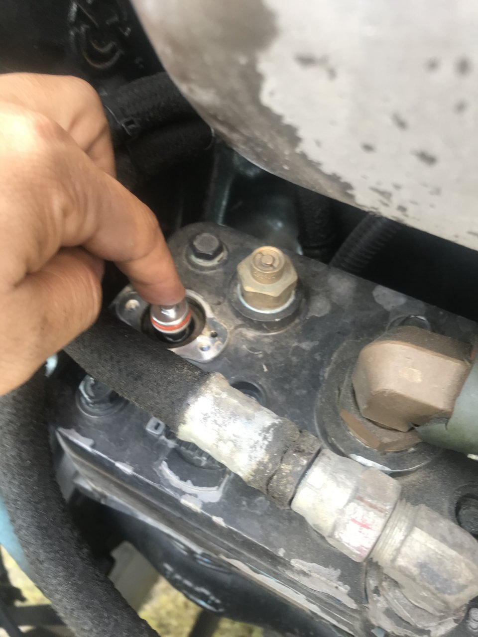

    After exchanging, I didn't know the part that the spring went in(the piston) has to be changed too....

    This was the problem..... changed em both this afternoon. Let it run for a bit and no issues D9E5C5F2-F453-4C3F-B66F-CE9AAEE57B41.jpeg 6D0352EE-6A21-456A-BC07-898344CB2536.jpeg
