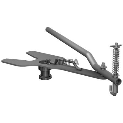

  8. AModelCat
    29,744
    165,237
    Most shops should have a tool to check that. Looks like this.
    Takes all of 5-10 minutes to check.
