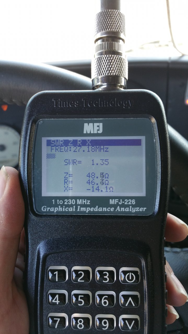

    Seeing as how this thread was started for me (although I had no intentions of bringing my issues to the board until I figured out what the problem was,) I'll jump in with some numbers and hope that I can get some help figuring things out. The problem being very poor TX and RX with not just my MS tuned radio but my stock Cobra 29 as well. By very poor I mean often less than 2 miles RX and rarely more than 4 miles TX/RX on a regular basis with my 98 vhp. 7 miles once. But again it's the same issue with two radios so it's obviously a connection/installation issue.
    14 Prostar. Predator 10k dual coil short whip mounted to upper mirror arm and grounded to door.
    Numbers on the ohm meter:
    From barrel of cb end of coax to bare metal of door = open.
    From barrel to bare metal of door jamb (cab) = 4 ohms.
    From bare metal of door to door jamb = 2 ohms.
    And weirdly, from cb end of coax barrel to negative lead of radio power wire = open.
    Attached is a pic of my analyser reading. Please help.

    Pics of antenna on truck?
    Should tune for x=0
    disregard swr
    I never saw a negative reactance number before.
    I would try a 102" whip and see if that helps.
    Reason for edit: negative x
    darthanubis Thanks this.

    "And weirdly, from cb end of coax barrel to negative lead of radio power wire = open."
    That doesn't seem right if both are grounded
