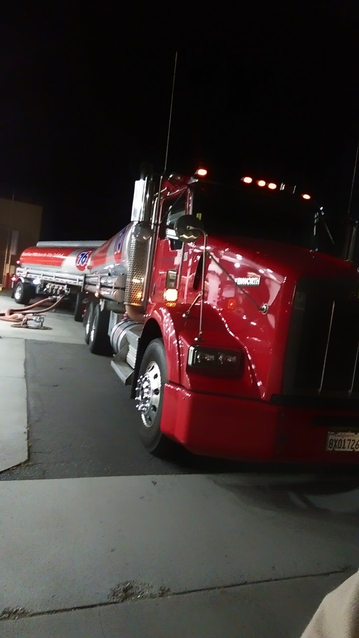

    A truck and pup only pivots at the hitch, you are driving a "truck and trailer". One cargo container is mounted permanently on the trucks chassis and the trailer is connected via a pintle hitch, the front axle of the trailer is on a turntable and the rear axle is fixed.
    This combination backs the exact opposite of a semi, the trailer will copy the truck.
    If you want the trailer to back left you turn the steering wheel left while backing, just as you would if you were backing a bobtail with no trailer.
    The Geometry seems confusing at first but once you see it work it is just a matter of learning how dramatic a move you can make and still "recover" or "catch" the trailer and bring it back straight.
    The longer the drawbar the more forgiving it is to a beginner, tankers also have a large overhang behind the drivers so the hitch is well behind the trucks pivot, this amplifies the action so you can be pretty wrong and still "catch" the trailer.
    Don't beat yourself up over struggling with backing a truck and trailer combo, this is a tough skill to master for anyone but even more so for a brand new driver.
    I know a guy who has driven for years in a semi who started with us 2 months ago driving a truck and trailer, I saw him last week and he still can't relearn his semi backing habits so he just quit trying! He only makes u turns and his boss parks his truck every night.
    Back it like a bobtail and you will see it respond in the mirror, then just work on how severe you can turn the wheel to keep everything from going to far out of shape; once you see it happen by your own hand your mind will click and you'll own it.
    Then someday you will climb in a semi and forget to do the opposite, nobody makes fun of a driver struggling to back a truck and trailer but everyone laughs at a semi driver who can't back up :)

    Grant it this isnt a backing situation your setup can make or break you, just like in a semi. You have to try to make it as easy as possible when positioning your truck, this way your aren't fighting to get both your trailer tail and turntable where you want. Also when turning into stations you have to remember these t&t setups don't like to be swung wide like a semi. The tighter you pivot the truck the more your pup will bend around a corner/ object. And always, I mean always leave yourself enough room to straighten out you rig if the turntable/dolly gets too bent out of shape. Alot of drivers get stuck because they end up soo twisted up they can't pull forward or back out of a situation.

    I am competition minded. You show me that fine truck with it's pretty parking at the fuel area. I want to take the truck and trailer and put up 50 dollars and seeif I can park it faster than you just so.
