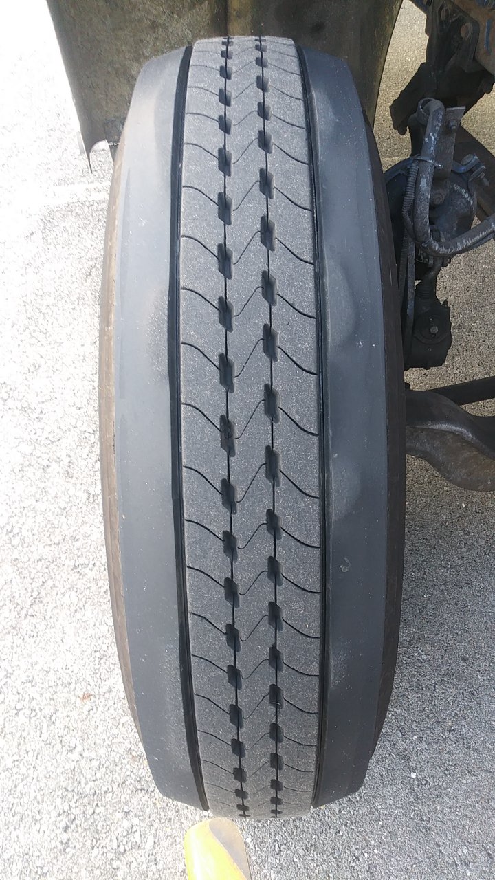

    The old man, lifetime trucker, at my shop has smashed 3 tanks in a month or two. Ive been out networking for my next job, stopped at a reefer shop and found out theyd fired him just before he came to us.. Said if he was younger theyd have whooped him. Wrecked all sorts of stuff and one truck in very short time. Complete trainwreck, doesnt care at all, no remorse or shame. Theyd just put on a brand new bumper hed smashed, and he caught that new one on the owners truck leaving the parking lot. Unreal.
    I will take a never drove a truck ever, floor sweeping 18yr old over that guy who cant be changed. I can mold clay, but not that old brick.

  4. FoolsErrand
    FoolsErrand Road Train Member
    2,877
    12,170
    Sep 15, 2017
    Wouldnt fix the shot steering box.

    I'm thinking Kingpins , a word to the wise always jack up the front end off the ground to lube the KPs, looks dangerous yikes.

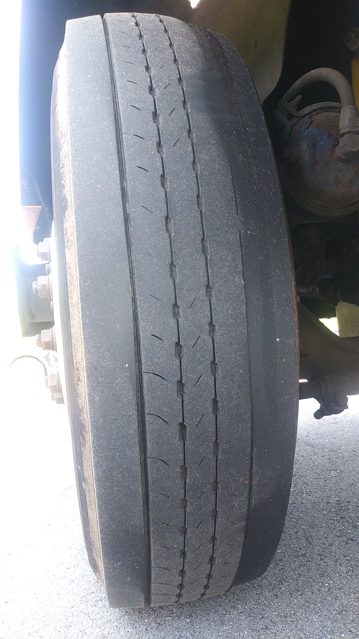

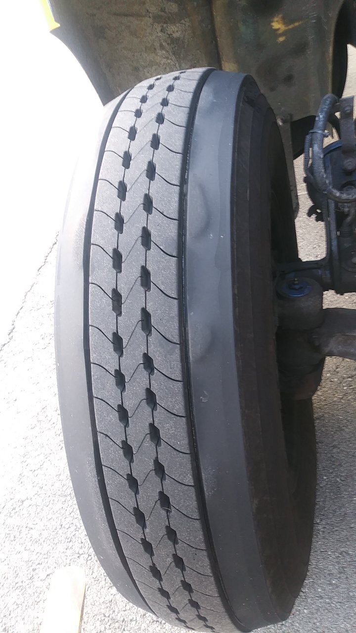

    This is a classic alignment or king pin problem, and by the way it has nothing to do with losing a wheel.

    You ever lost a wheelhub?
    I have and the tires didnt show one bit. And trust me, there wasnt nearly the warning you think thered be. From the first sensation of wtf was that, to omg bang, was hardly enough time to slow down.
    That truck pictured has bad everything in the front beam.
