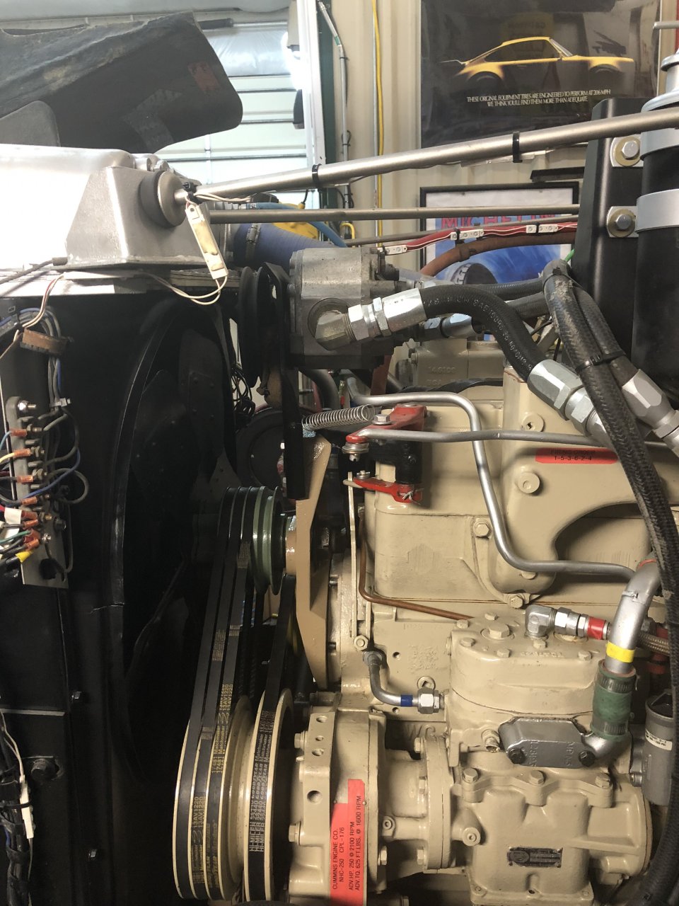

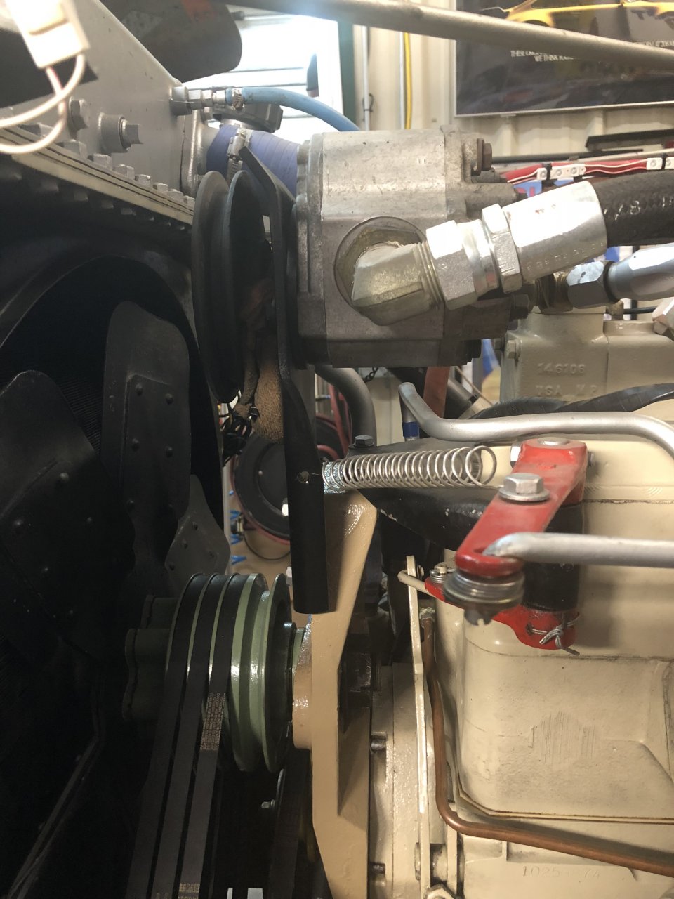

  10. SmallPackage
    5,813
    18,627
    Dec 20, 2019
    Marion Texas
    here is the vickers set up on the 250 in my White 4000. The belt is off but you can see the groove in fan hub it goes to.
    ElmerFudpucker and cosullivan26 Thank this.

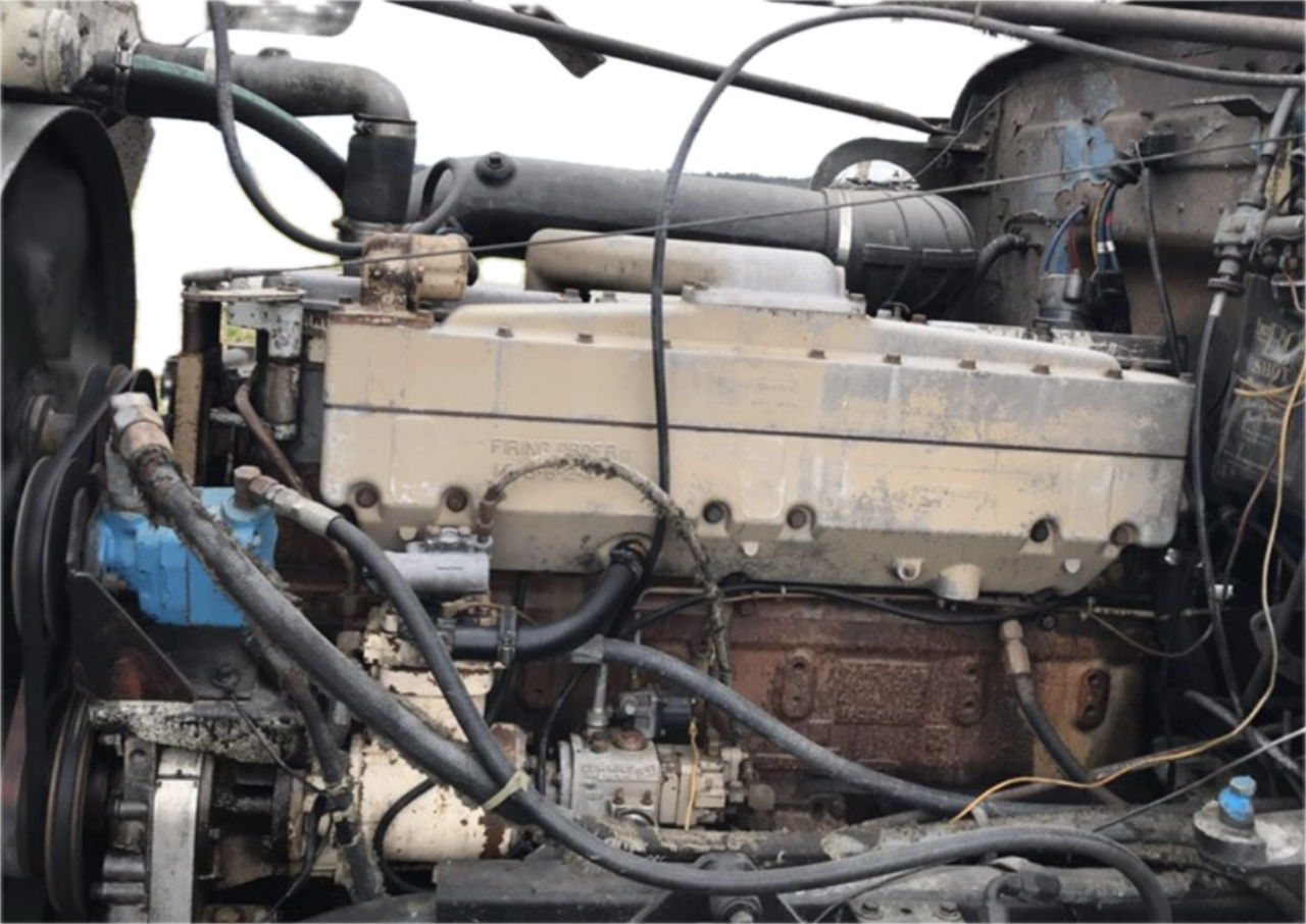

  11. SmallPackage
    5,813
    18,627
    Dec 20, 2019
    Marion Texas
    here is one on an early 350 in a ‘70 w900 we had years ago.
