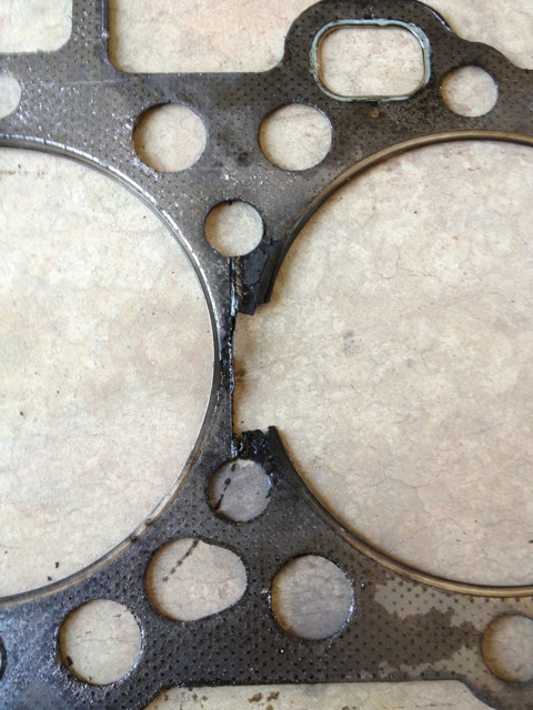

    Now if that happened right after the new turbo was fitted you would be wondering about weather the new turbo caused it.

    thats what i thought happened that the top turbo puked. but noooo!! it is a liner or head or head gasket.

    well tore it down yesterday blew the headgasket on #2 cylinder. either the headbolts stretched or the liner droped. havent checked the liner height yet. i think with the high boost and the extreme conditions i run it under it couldnt take the pressure so with kurts insight and my pocket book im converting to a single turbo with the lower compresion pistons and a few other things. IT'S ONLY MONEY! anyone want to buy some acert parts??

    Look like this? Mine was a cracked liner flange.

    Excessive speed and overloading,pretty obvious.
