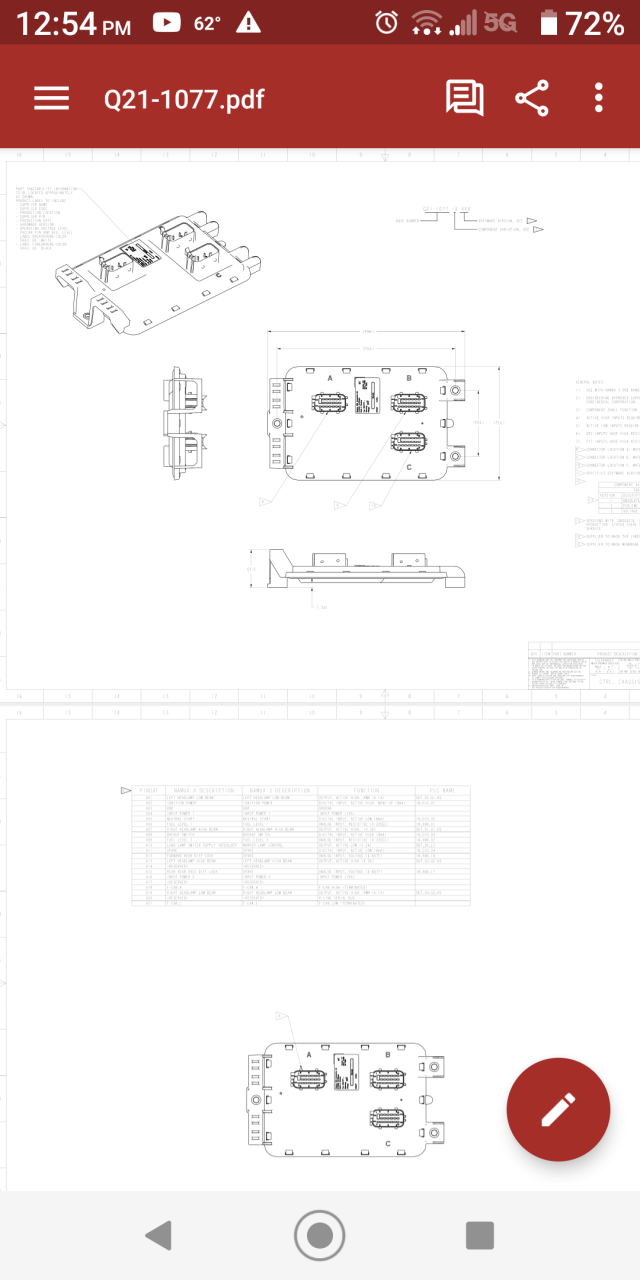

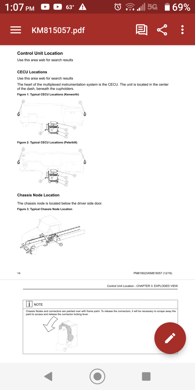

    Does anyone know where the Chassis node on a 2014 T680 is? Trying to check connections to fix a lighting issue and i feel thats the best spot to check...
  3. Goodysnap
    Goodysnap Road Train Member
    3,784
    9,223
    Jul 12, 2017
    Most often under the cab below driver feet area just behind the LF cab mount outside of frame. Might also be between the frame rails behind the trans but ahead of the first drive axle. Black module 3 connectors labeled A,B and C.
    VIN can narrow it down

    Last 6 is 415812 I'm not finding it lol

    Think I found it. Thank you maybe you will know this then.
