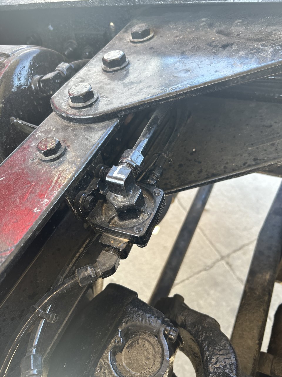

    Why is when I push my brake buttons In these lift valves for my axles that are up in the air they are pushing air out of the bottom exhaust port but when I pull the button they stop exhausting is it a faulty valve or why is both axles doing it Thanks

    There may be a hole in a brake diaphragm letting air pass by which then needs to be exhausted like when you let up the foot treadle. It only takes one diaphragm in the whole system to cause all kinds of issues.
