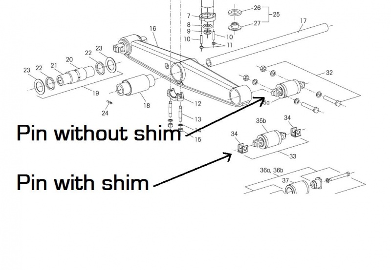

    Sorry, I just had a nice long post typed out to help you, and somehow I lost it. Here is the quick answer. Rotate your tires. Get a 3 axle alignment and see how bad the rear axles are and if they need adjustment. You have a nice suspension but that is the type either you can or can't do. It depends on the type of bushings you have. Some are a bit smaller where it bolts to the axle hanger to accommodate the alignment shim. If your axles are out big-time and you don't have the align-able type, you would have to change all 4 bushings. Not cheap. The alignment shim is part 34 in the picture I included. It can only be installed one of three ways to get a coarse adjustment only, but it helps.

    hay thanks heavyd ill check my book i know its the hend. 460 so ill look and see if i have the shim in my set up but you guys have been a great help,and ive learned alot and love to do whatever i can to save money..i dont have the 1400.00 that they want to replace the king pins and do a aling. i just put 3500.00 in a new computer that cummins atl. bent me over backwards for hahahaah..
