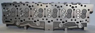

    The only idiotic thing I see with all of them is the relief cuts in the head. I wouldn't be scared of having them filled and the head decked.

    Do you know the reason for the relief cuts being there in the first place?

    I was told it was there to make the gasket blow toward the bolts and not toward the water passages. What I don't like is the last 3 blown gaskets I've had on 3 different engines were all blown toward the relief cuts.
