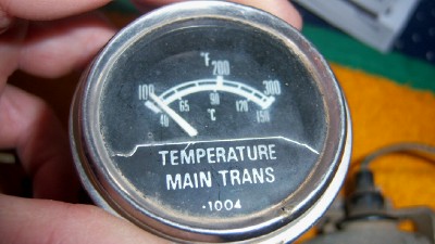

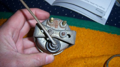

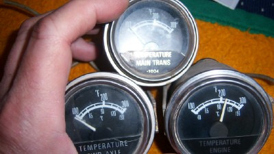

    Would anyone happen to know the part number for the sending units for the factory temperature gauges ( engine, axle, trans) all identical Stewart Warner gauges from a mid 70s early 80s KW that all carry the number 828227 on the face up at the top and the KW number K152 245 on the body of the gauges with a marked temp range of 100-300 but it looks more like 100 -325 by the extra short mark at the end of the scale
    Thanks

    K379-12, standard temp sender for axles!
