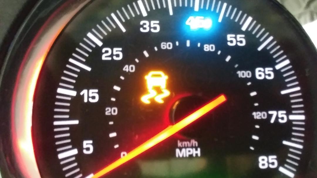

    2009 KW W9, the traction control light has a mind of its own. It comes on, goes off, stays on, stays off, flickers, is this an ecm issue, loose wire, anybody run into something similar?

    Does abs light come on at same time . A bad abs sensor can trip traction control light on most trucks I’ve driven.. problem often is a corroded abs sensor it seemed.

    I'm going with faulty sensor for $250 Alex.

    Nope, no ABS lights at all.

    Stability control. Need to hook up Bendix. Most likely Bendix anyhow.

    Some days it stays out for awhile, hit a bump, comes on, flickers, goes out. No real pattern, just all intermittent.

    Oh boy, intermittent........my favorite. Most likely a wiring rub somewhere.

    And Murphy's law says the wiring rub will be under 5th wheel covered in grease.

    Or where all the wires become 1 big bundle with no play in them .
