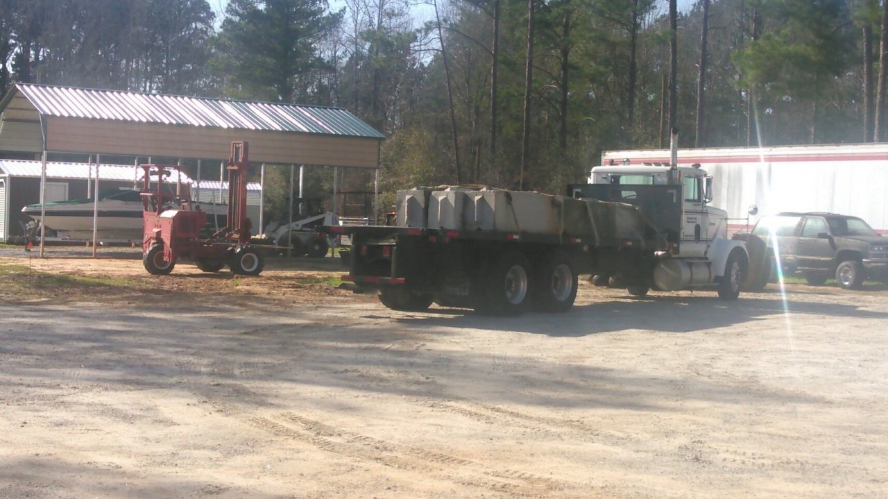

    I have a mechanical M11 - L10 mechanical hybrid. Get about 6.5 MPG loaded 50,000 gross one way. That is baby footing it. It can turn the sky black and pass slow cars on demand. Even the 11L can be really weak on the low end. KIMG1750.jpeg
