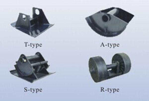

    Get some steel plates and place them under the landing gear foot, so the foot slides smoothly without the landing gear bending. I’ve seen these steel plates used at dealers when dropping trailers to prevent the landing gear foot from damaging or sinking into the asphalt. I have never seen someone sell these, though. You’d probably have to go to a steel shop.
    I just thought of an even better idea. Replace the landing gear foot. See images.
    Edit—
    Dam, someone beat me to it, and even used the same image. Hahaha. What a coincidence!

    PE Trans: I like the idea of a steel plate under the T style pads to aid in the landing gear to slide ahead a couple inches.
    Our step deck has landing gear that’s close to the ground so it doesn’t travel much and has very little movement forward or backward.
    It will slide the pads ahead on any surface when loaded.
    cke and PE_T Thank this.
