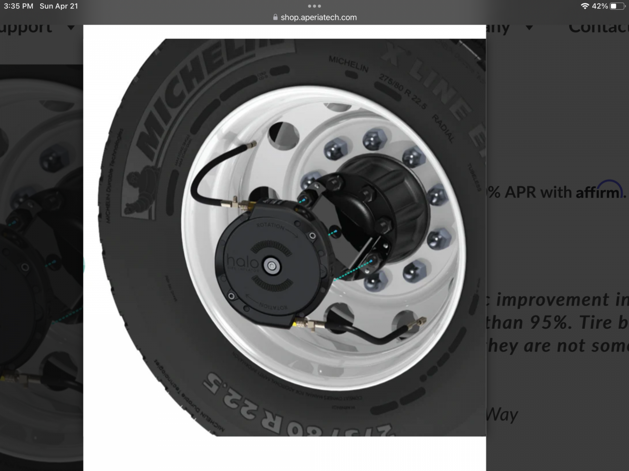

    The Halo Tire Inflation System is actually a very good system for the tractor. I have been running them for 8 plus years and I run the Tire Max Pro System on my trailer. In conjunction with a Tire Pressure Monitoring system to see an issue that occurs while driving and in between my morning pre trip tire inspection/post trip tire inspection. IMG_9400.png IMG_9399.png

    Tried them but a couple of winters across 80 and they were so corroded inside they quit working.

    I run the Midwest and don’t leave the house if it’s snowing but haven’t seen that issue in 650,000 miles of use. They salt the roads around here if they are calling for a flurry, but my rig gets a bath nearly every week. Mine have paid for themselves several times over. I had one not working properly after a couple years and they replaced it at no cost.

    WI to CA and back. Got a couple of sets free to try them, by the second year they quit working. Quite a while ago so they may have improved/fixed that.
    Trailer PSI systems are pretty easy and very few problems. Had hem on most of the trailers since 2004.

    The first system from Halo was a real chore to get reattached when having tires put on if the tire guy couldn’t follow directions. The latest system is very easy with only one bolt to tighten. There is enough free play in the hoses if the tire guy doesn’t mount the valve stems across from each other they can still mount without repositioning the wheels. I wouldn’t do without the trailer system and feel it is a no brainer when ordering a trailer. It nearly eliminates road calls.
