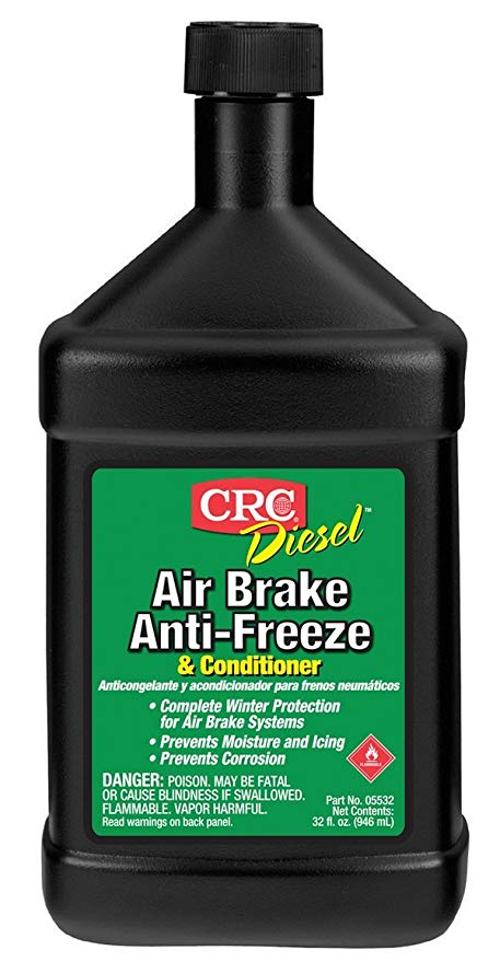

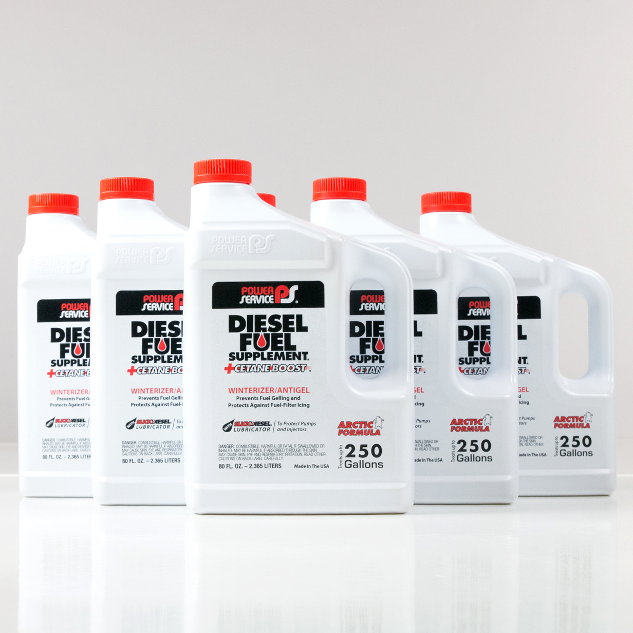

    Top picture I’m using that stuff this year. Last year the Howes failed me.
    That airline treatment I have in standby as well. However, never understood why it says “diesel” when it’s meant to go in airlines? Why would diesel have anything to do with it?
