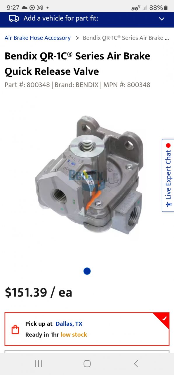

  9. Big Road Skateboard
    6,651
    37,333
    May 2, 2021
    Quick release valve. It'll be a smaller valve under the 5th wheel. Gonna look like this.
    Very, very common
  10. stylez80Nine
    stylez80Nine Light Load Member
    185
    58
    Dec 2, 2018
    Would this be the one the middle of the pic I sent? Cuz the other valve it’s on the back of truck
  11. Big Road Skateboard
    6,651
    37,333
    May 2, 2021
    No, the pic you posted is the ABS valve. The quick release valve I posted has a signal line that comes from the ABS valve.
    The quick release valve fails, leaks air down the signal line into the ABS valve. Which comes out the exhaust of your ABS valve.
    They can be mounted in different areas, but in general they are normally bolted to the crossmember under the 5th wheel.
