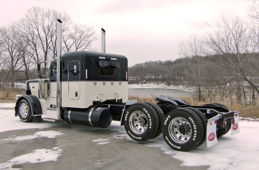

    IF I was in your shoes, AND I was spec'ing new tractors, look into the 6x2 units, basically they look just like a tandem tractor but only ONE drive axle, other axle is dummy, just there for carrying weight.
    Also you COULD look at having a "drop" axle on a S/A truck, when you need it you could pick up another 12,000 of capacity, when you don't need it, raise it up, saving fuel, tires, and tolls, just a thought.
    For my money Volvo has about the nicest 6x2 setup that I have looked at.
    [​IMG][​IMG]
