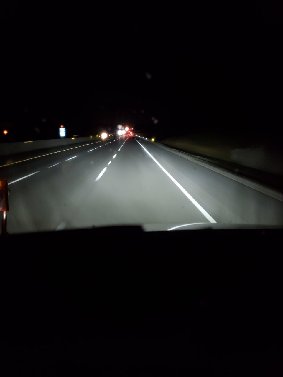

    as long as the lens (plastic is good) just change the bulb to LED. This is my prostar with just the LED upgrade... got the LEDs at Advance

    My lenses are shot, and I find that just adding the led lamps to regular lights that aren't projectors make it hard for on coming traffic.
