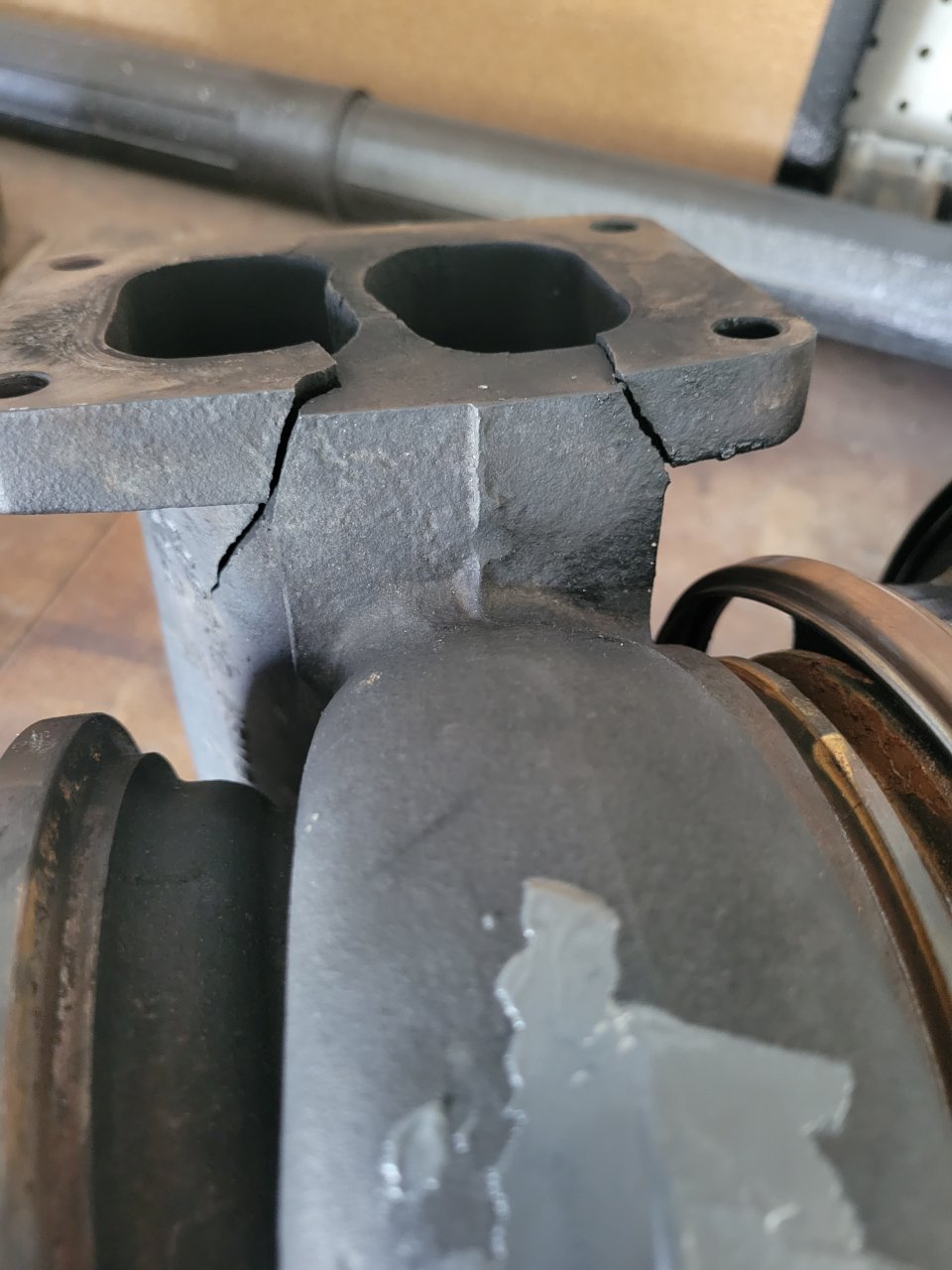

    I don't know about heat/fuel causing that.It seems like something else might be going on there. Did you bend the oil return tube to fit or use an E model flexible hose?
    Was that BW or a knock off? Sucks either way.

    It's the real deal straight from BW.. I put a new E model return line on it when I put it on .. There's a Diesel shop about 20 miles from me called Excel Enginerring.. that test Diesel Engines of every type up to 4000 hp .. and that 's their job is to make them fail (they know their s@$%! ) I went through them when I got it... alot of the tractor pullers in the midwest have them get turbos... they don't have a answer for it either.. other than fuel & heat cause this.. or thats what their telling me anyhow

    That just sucks. Do they have any recommendations?

    I was in there yesterday afternoon They are gonna call their turbo outlet and see about having a turbo built....
    Here's the full disclosure on this truck.. I bought this truck with a bad turbo it had a A/R .95 ACD turbo on it that the bearings were shot .. the tard I bought it from was a blow hard that I didn't belive 80% of what rolled out of his pie hole.. But is a straight corrosion & rust free truck that has the right components to build what I what.. anyhow he kept blowing about how strong this motor was ..figured he was full of it .. I did samples of all the fluids everything came back good.so I threw this BW 177148 on on it and pulled a couple loads this is the result .. I know nothing about whats been done to the pump just know it was OH by a Cat shop in Salt Lake in 16 and has 105k on the OH

    What egts and boost were running through that cracked up 177148

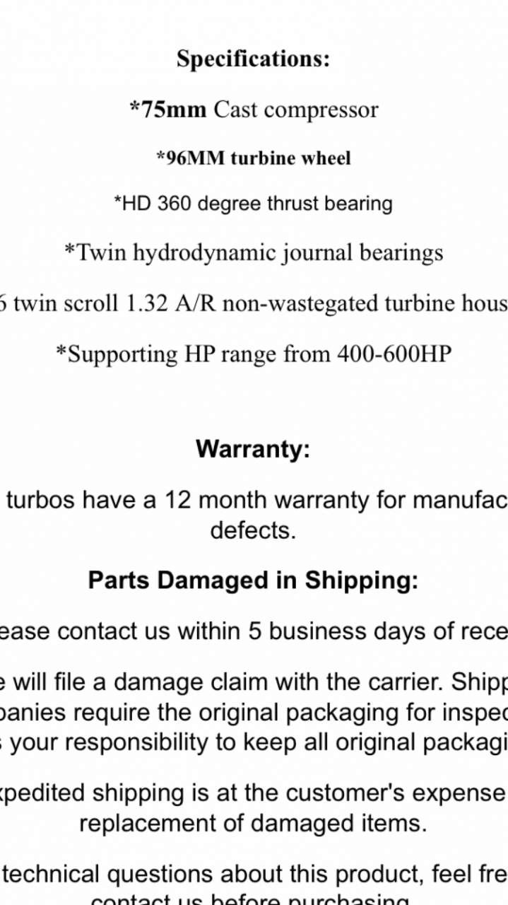

    I came across a speed shop ad on eBay for this turbo, I think they were in Iowa but I can’t find it now. It sounds like it takes up the space between a 177148 and the 1.32 stage one bw but would probably overspeed easily and I don’t know where they source their parts.

    Fuel did not cause that unless your tune up is way off, if the cast was hot enough to deform there would also be material removal from the exhaust flowing past it.
    It takes sustained 1300*+ to start to make cast glow.
    Borg likely wouldn’t cover it no matter the charger though, the are on par with most OEMs with trying to get out of warranty.
    Who did you purchase that thru?

    Have any pictures of the side of that turbine housing where the numbers would be?
