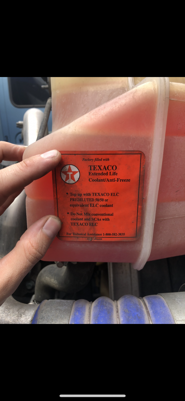

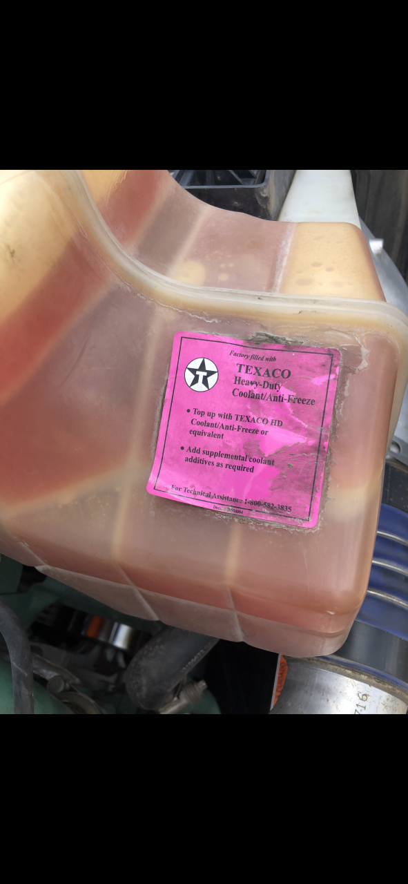

  5. Newto Trucking
    Newto Trucking Medium Load Member
    359
    226
    Dec 26, 2013
    NE Illinois
    This are the two I’ve seen on a Volvo with d13 engines. 85% of them were red stickers
    mladen86 and PE_T Thank this.
