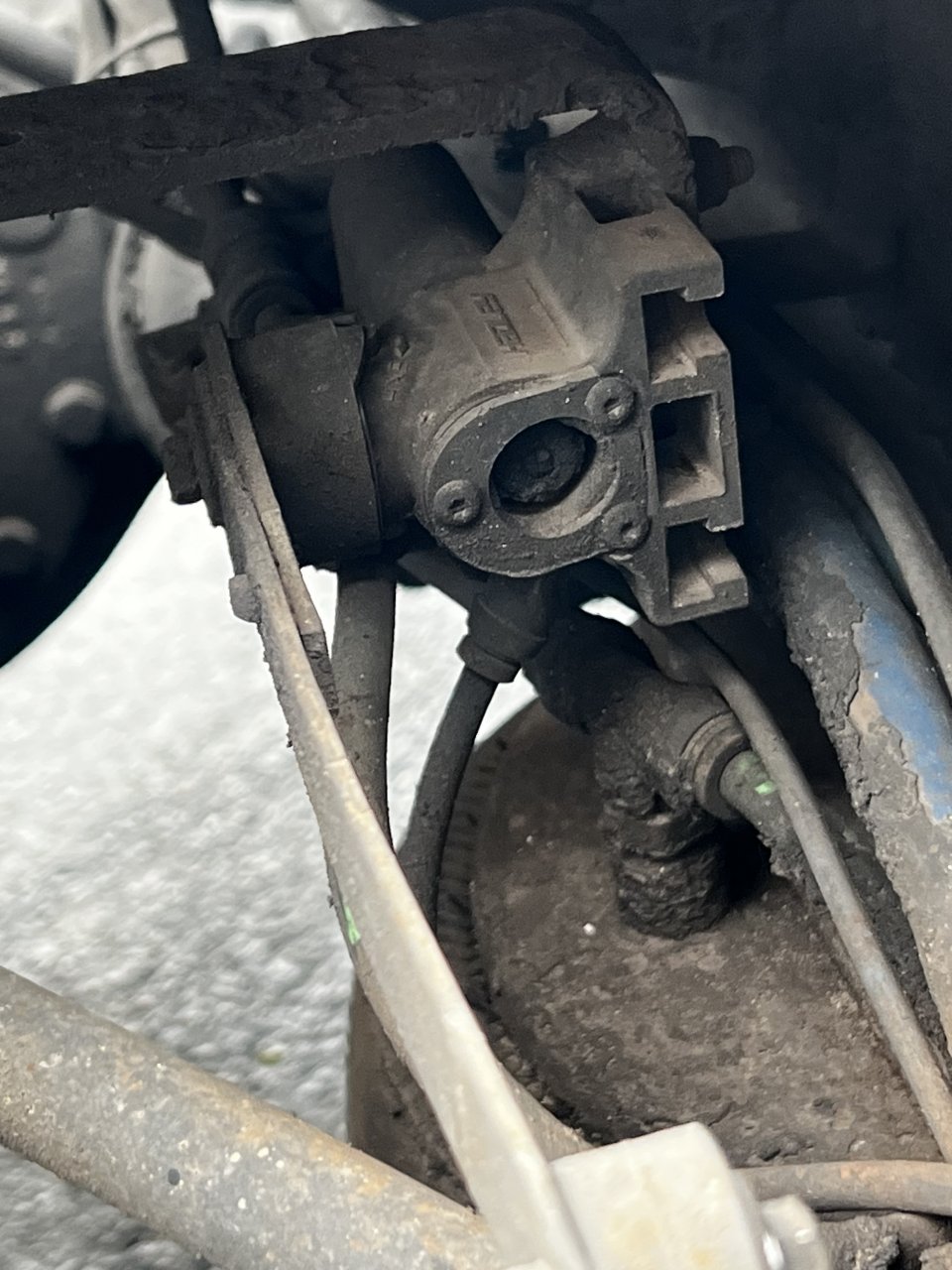

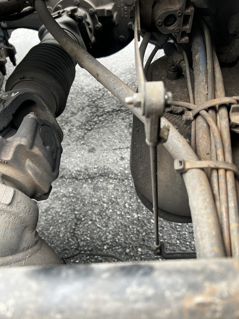

    Question replacing my leveling vale, upon looking it’s a different valve style International said this is “replacement to the old style”. The old valve is longer on link that connects to the rod, but correct me if I’m wrong as long at the rod is cut to spec doesn’t really matter on the valve if it’s short?
  3. Oxbow
    Oxbow Road Train Member
    13,752
    142,665
    Nov 24, 2015
    Correct, as long as the shorter bar on the valve doesn't cause the rod to interfere with anything, like that hose that appears to be dangerously close to your inter-axle driveline.
  4. LeviTrucker
    LeviTrucker Bobtail Member
    34
    5
    Mar 24, 2022
    Good point I’ll re-route it thanks kindly for the suggestion and advice

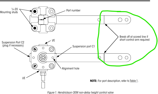

    The angle between the vertical linkage and level arm from the valve should be 90 degrees with the truck level. If the new valve level arm is much shorter that is going to throw things off and you will have to adjust the ride height. What is the difference in length between the old valve rod and the new one?
    I'm also wondering if the parts person gave you the wrong valve. Above is a Hendrickson trailer valve.

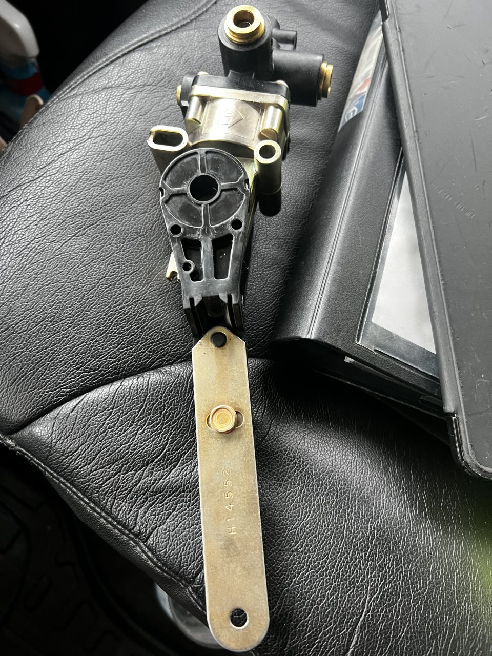

    Thanks for information, yes this is what International gave me attached is the part number it’s was for a 2003 International 9400I VIN 2HSCNASR73C078182
    Do you what the measurements for the metal rod should be then since they replaced the old valve with a new style?
  7. Big Road Skateboard
    7,282
    41,506
    May 2, 2021
    The rod needs to be whatever length brings ride height back to spec. There's usually some adjustability in the valve mounting too.
    Often, you'll also have to replace the rod also.
