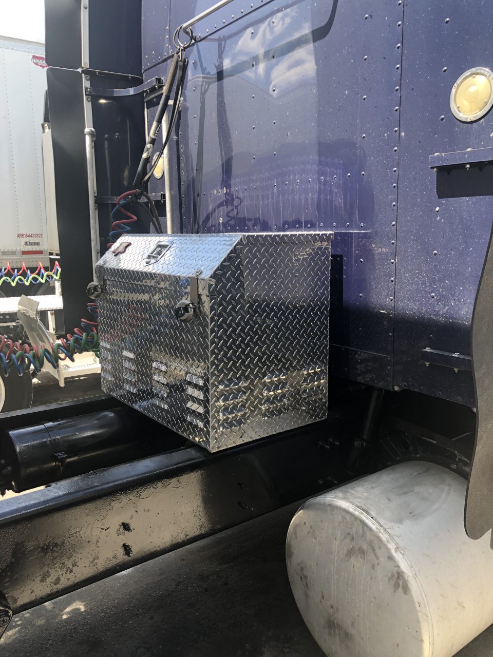

    17412D0A-236E-4767-A4B1-4F9D9AFF7745.jpeg Well She’s riding very well, now. Didn’t check height, but looking at airbags, I can tell it hasn’t moved. Still at 2 5/8” Had to make a better height rod for cab A/R as original has always been a little short. All metal from ACO. All new shocks, that’s where it’s at.Like Butter!! Had to do something with the frame, not the greatest. But better than nothing. Got all the tools out of side box. That helps too. Cab would bottom out, sometimes. Lol. Front Monroe’s seem to be good, Time will tell.
