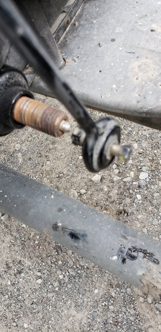

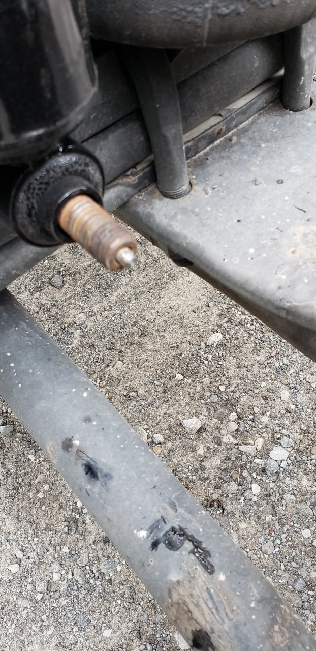

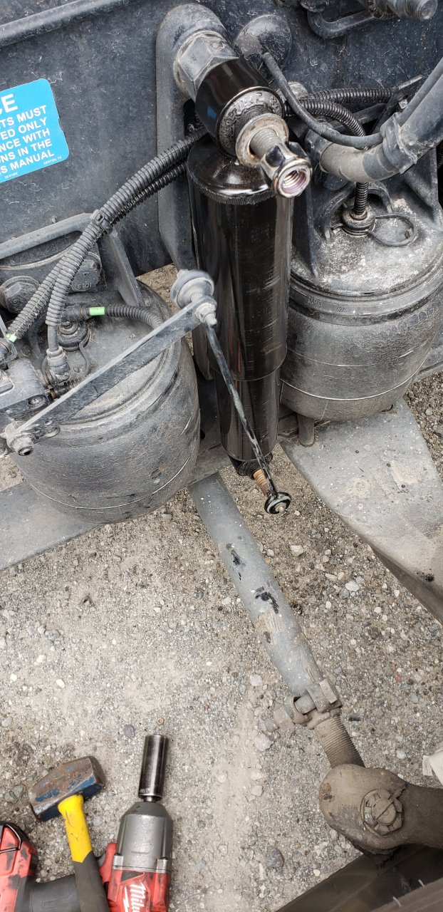

    Tried removing this bolt today and it cracked soon as I started turning on it. It appears that entire stud the shock sits on now will need to be replaced? What is the correct way of removing this linkage?

    Is that little stud threaded into the shock stud? Might just have to extract the little broken one and replace it.

    I believe it is not 100% though thats why I was asking. Tried putting vice grip on the little stud and turning , it won't turn?

    I would throw some heat on it and see if you can get it to move.

    Its a little late now but why would you use a heavy duty impact gun to turn a single small bolt?
    Have it welded back together and use a wrench to turn it while its still glowing hot.
    Using the right tools for the job is half the battle.
    A lump hammer and heavy duty impact wrench aint it man.

    The impact gun was used to remove the 2 shock bolts, as I was installing new shocks today. The hammer was used to "tap" the old shocks to help them come off the stud.
    I did use a small hand ratchet on the linkage part that cracked.

    I see. Can you weld it back together? The heat will loosen it so it will break free. But youll need a new bolt either way. I wouldnt use the vise grip unless you can get it glowing red with oxy accetalyne torch. Propane and going to do it.

    I dont have any welding capabilities. Will take it to a shop up the road in the morning..
