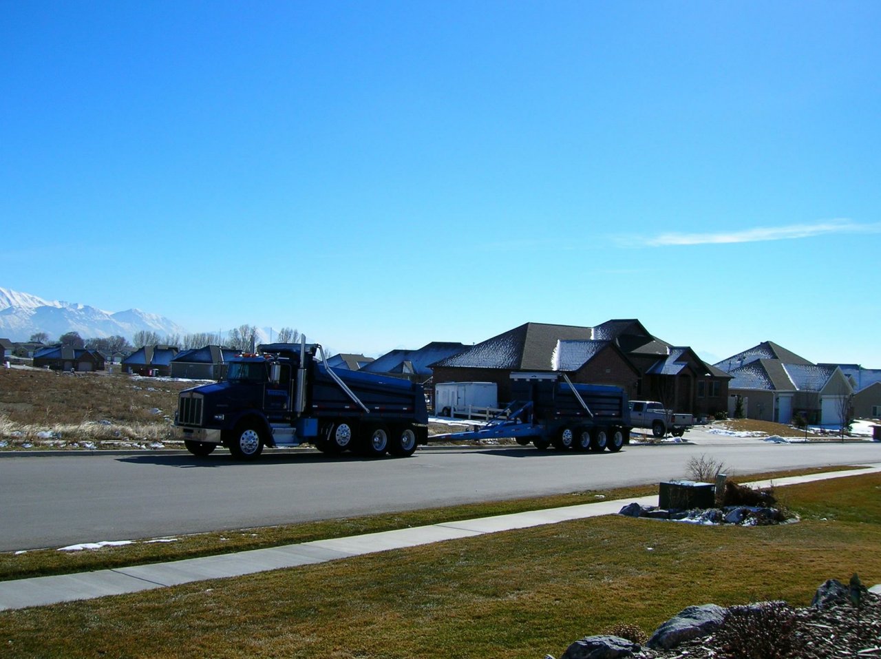

    Also consider physics. I had a 224” wheelbase Kenworth T800 with the lift mounted @ 9’2” which put me in a 10’ bridge (#43,500). My 260” wheelbase Peterbilt 379 EXHD had the lift axle mounted the same (9’2”). I could pick the weight off the steer axle of the Kenworth by simply adding air pressure to the lift axle. On the pete, it would pick all the weight off the drives.
