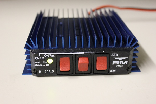

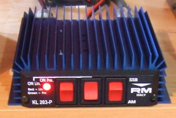

    RM_Italy_KL203P%20(1).jpg I've got a similar 1 but is only 100 watts and made by RM in Italy. You get them on ebay. Mine is a lot smaller and blue in color it's the KL 203-P
    Your left switch is on/off, your middle switch is AM (CB) when down, SSB(Single side band) when up. Right switch is hi power or low power.
    On the KL 203 it always operates at hi power but has a 3rd swicth for pre-amp, increasing its receive capability.
    SSB won't do you any good unless you have an SSB radio.
    Single Side Band CB's are pretty good, especially around channel 38. You can talk to truckers all over the U.S., Canada, Europe, N. Africa, Mexico, and sometimes S. America.
    It's just like the HAM 10 meter radios. Propogation on 10 meter and 11 meter (c.b.) only works during sun light.
    10 Meter is better than 11 meter SSB because Ham's have better conversations. On SSB C.B. they basically just keep calling out to see how far they're transmitting, no real conversations.

    So if I turn my left switch to on and the far right switch up I will be on hi and it will help me recieve signal? With it on hi will i beable to talk further? I have only had it down so low and talked about 15 miles. How far have you been able to talk with this linear? Thanks for your replies

    The HI-LOW switch regulates how many watt's your going to be broadcasting....ON HI, the linear will be doing all it can do "Full output"...On LOW it maybe only doing about half it's full potential... On LOW it won't be working as hard, and stay cooler for one, Plus if your talking to someone close by, you flip it on LOW so you don't sound all splattered in their receive.
    That particular Amp does not have a "Pre-Amp" setting, so it's not going to help your receive...Just transmit...

    The blue amp shown (mine, sold on ebay, less than $100 on ebay) has a pre-amp. The red amp does not.
    Don't use the radio when the warning comes on. You need to get it checked at a CB shop or use an SWR meter yourself and tune the antenna so it gets low SWR's when the amp is both on and off.
    On SSB using skip, I've spoken all over the USA, Canada, Europe, and North Africa.
    On CB, I have no idea how far I've spoken because not too many people have amps and are able to answer me back.
