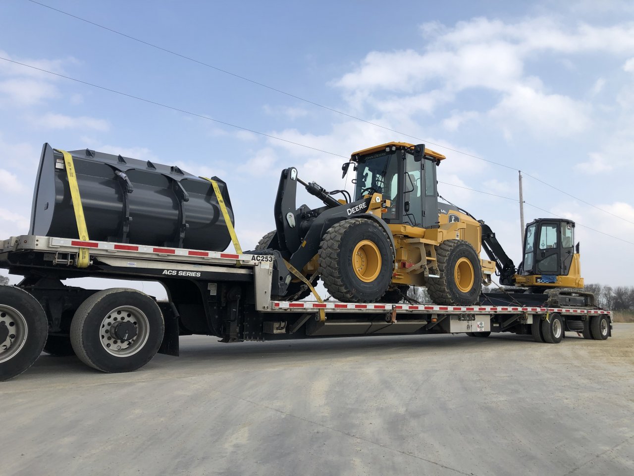

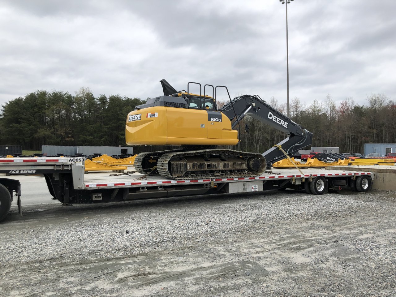

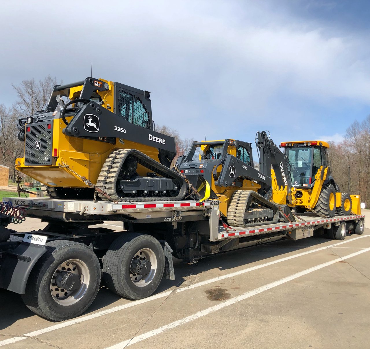

Steel with aluminum deck 17.5s. When loaded it’s 14,1” high. After chaining it 13’5” high. John Deere 544L. A 644L can be sucked down to be legal as well. Steel just lasts longer for us. Good quality tires and you’ll get 120k miles. Haul a bunch of diggers also. Obviously they would be wide and heavy. The 17.5s work great. Not too sure about going lower because of loading docks and tearing off the rear bumper. Yes that happens I have seen it but not done. Ramps aren’t necessary but when you have a track loader on the step and the place where your unloading doesn’t have a side load dock. You’ll wish you had the ramps.
