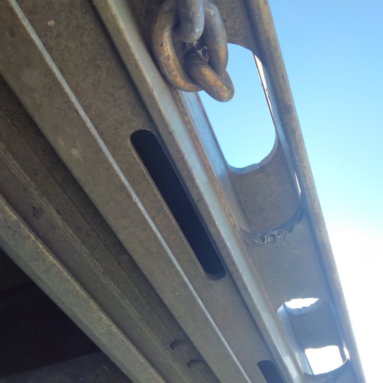

    I have a special insert for the hooks underneath. If u dont have that , then have to use the rub rail. Or there might be an open area to the inside that is for the hooks... just dont hook the winch track because its not rated for securement and u can bend it, then u wont be able to slide ur winches anymore
