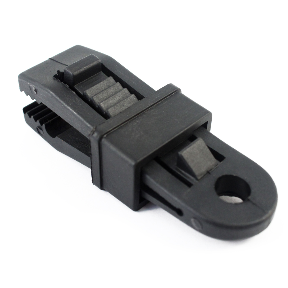

    They look like this. Small clips that you pinch on a tarp wherever you need a D ring/ O ring.

    How well do those work?

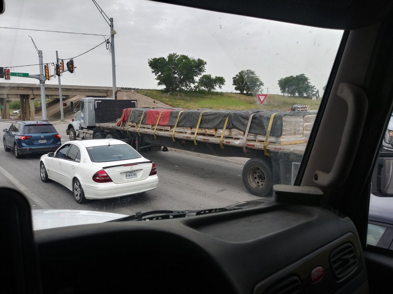

    OP, everyone here will agree that tarping shingles is dumb, but if co policy is to tarp them, then do it like this to save yourself some hassle.

    Get it done right, now matter how long it takes you. If not secured correctly, what you are hauling can kill someone or kill you. The more you do it the more efficient you will become

    Well i gonna have to disagree with ya here. There is alot of legal dims load on a flatbed that could take very long if ya got alot of sharp corners or odd angles, etc..i am usually the slowest and last one to finish tarping.
    Brettj3876, booley and farmerjohn64 Thank this.
  9. D.Tibbitt
    23,310
    161,849
    Or u could take an extra 30 mins and do it right....
    Straps over tarps especially on a square load of palletized prodcut ..... why ?
    Sloppy

    They work well. On his tarp with the missing D Ring string, pinch the tarp with the clip and tighten it, then hook your bungee through the O ring on the end of the clip.
    I bought them at a truck stop, they come 4 to a pack. I bought 3 packs. I have a small tarp that shredded one end of the grommets strip. Tarp was good except for that one end. I left the clips on the tarp when I folded it up. It held up to the wind without coming loose, so they did the job I needed them to do.

    Yeah I should’ve used two tarps
