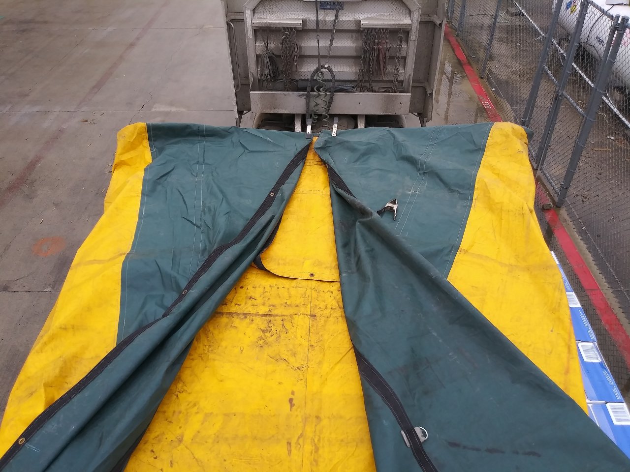

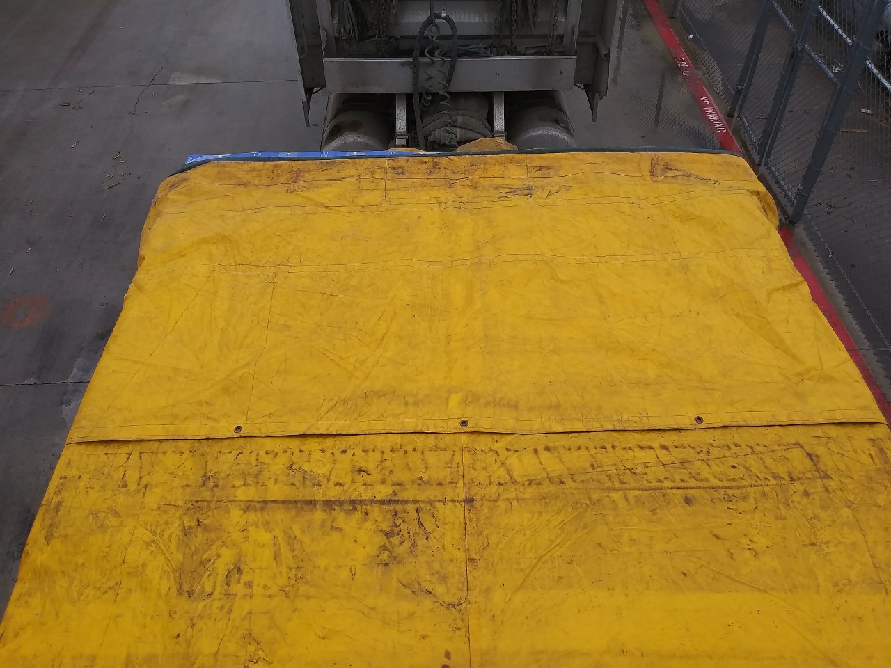

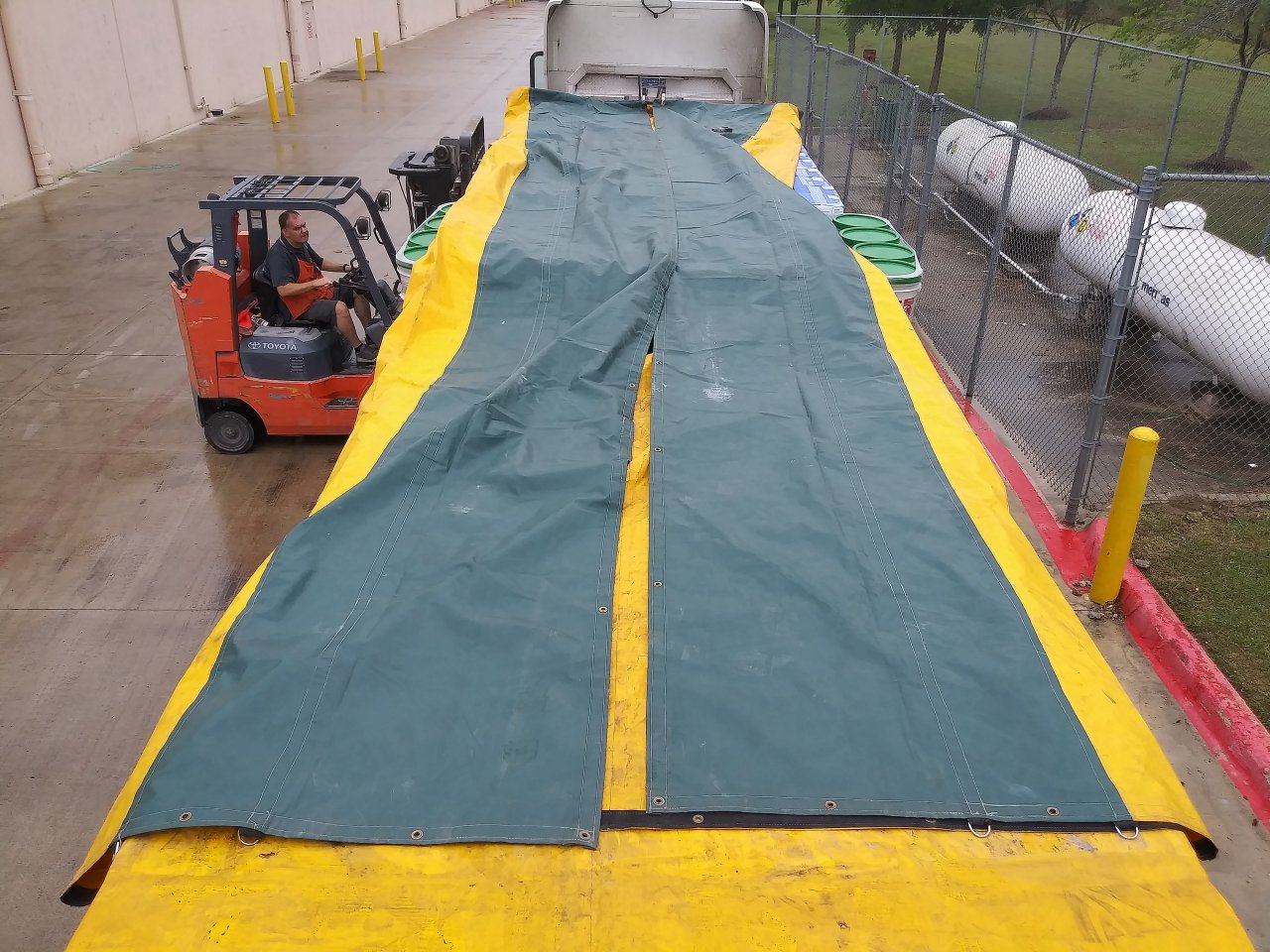

    Okay quick and dirty...
    Fold your front/rear flaps up on the tarp:
    Start at one end and fold each side to the center:
    *Note the clamps Im using to hold then ends. They act like a 2nd set of hands when folding the opposite end of the tarp.*

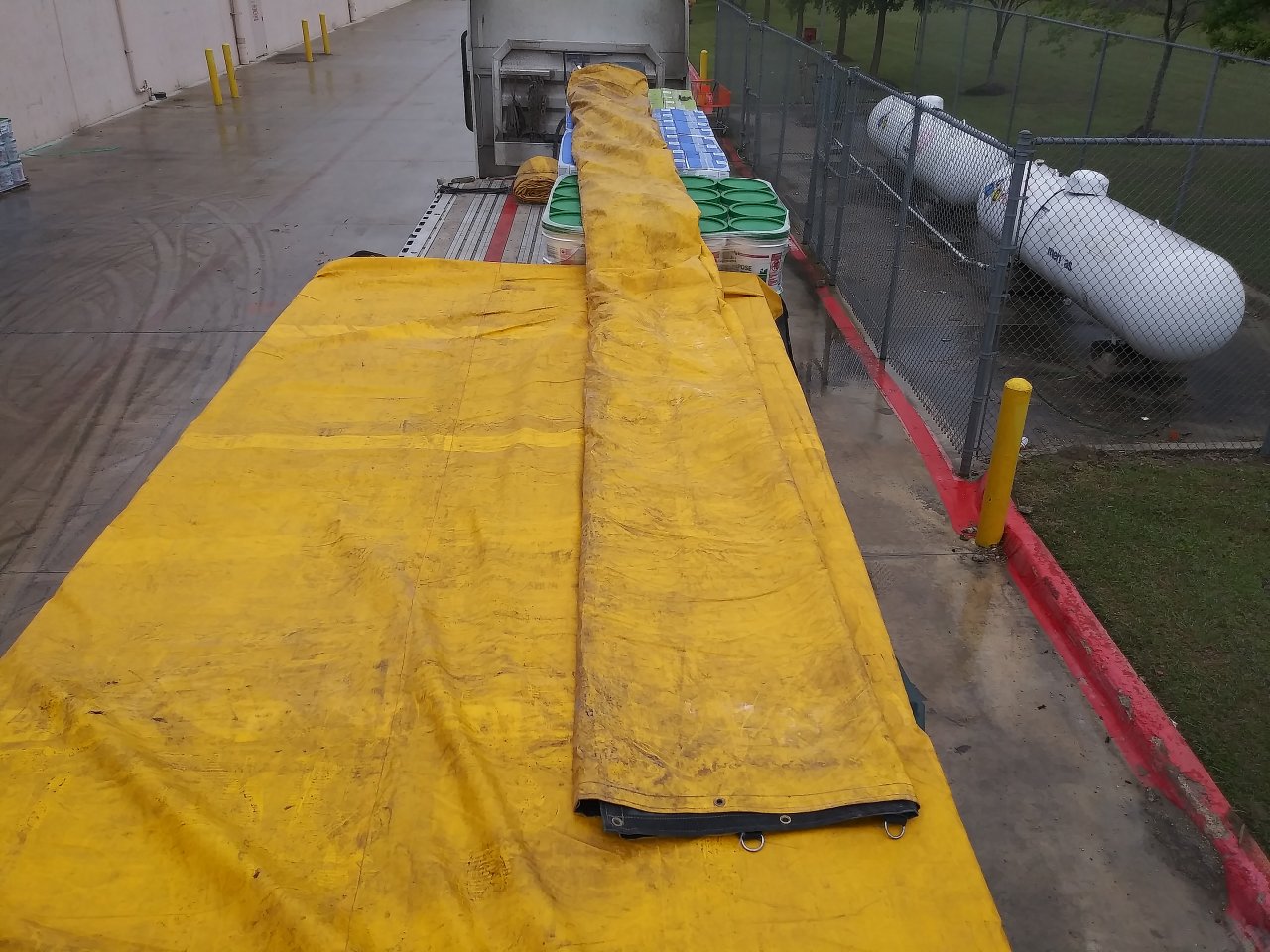

    Fold your sides over 1 more time so that they're completely folded up on top of the load:
    Then fold in half so that they look like this:

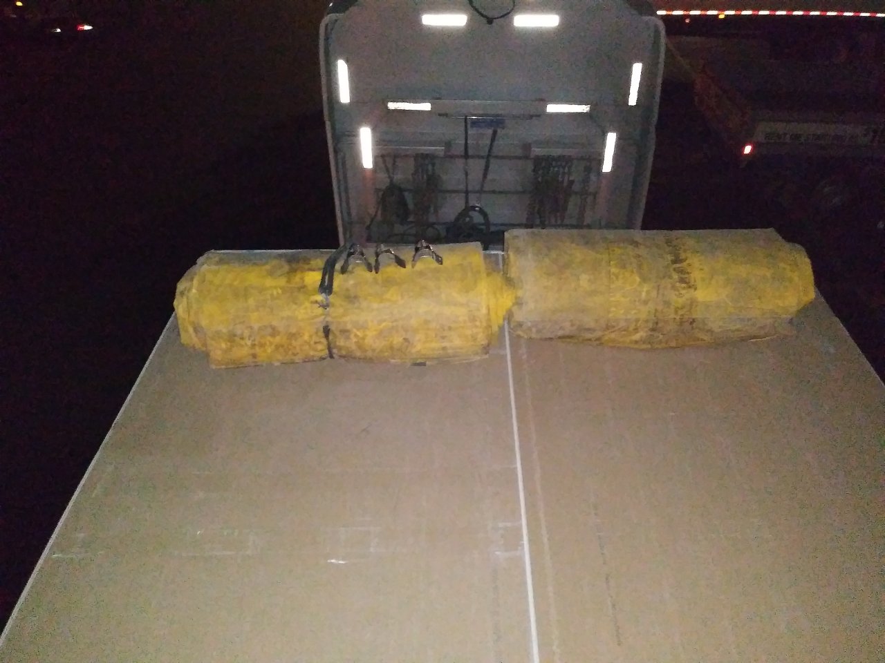

    At this point, fold the back upto the front it halfs the length, then roll them up tightly and put a bungee around them:
