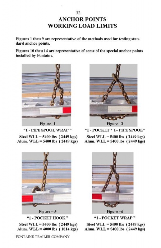

    So are you saying my 3/8 chains and ratchet binders tightened to the last turn would be bad on your alumnium trailers??? thought I was here to keep you busy in the shop LOL :biggrin_25523:
    ..... i use the spools even on the steel Fontaines i am pulling unless the pocket is needed, then I go ALL the way around the pocket to give extra holdability

    if you also run the chain along side the pocket and loop under the pocket and hook chain on other side of pocket you are using both sides of the pocket.
    and my utility lists spools at 6500 wll

    Yes, you'll have to check with your trailer manufacturer specifically. The spools on my Mac are rated for 7k.

    My company (same as AZS) says to always use the pocket, never a spool, And we go down next to the pocket come up threw it and hook to the inside of it (to the side that pulls against the welds.

    this is how i do mine (except i hooked to the wrong side of the pocket in this pic)

    at, isnt that using a spool?

    My interpretation of using a spool is using just the spool. Ie wrapping the chain around it and hooking it to itself above.

    proper way is around the spools not the pockets,just ask a dot officer the next time you go threw a scale
