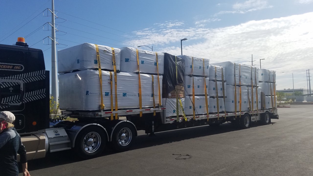

    We have a 2018. Great trailer, very versatile. Ours has the ramps to the upper deck as well.
