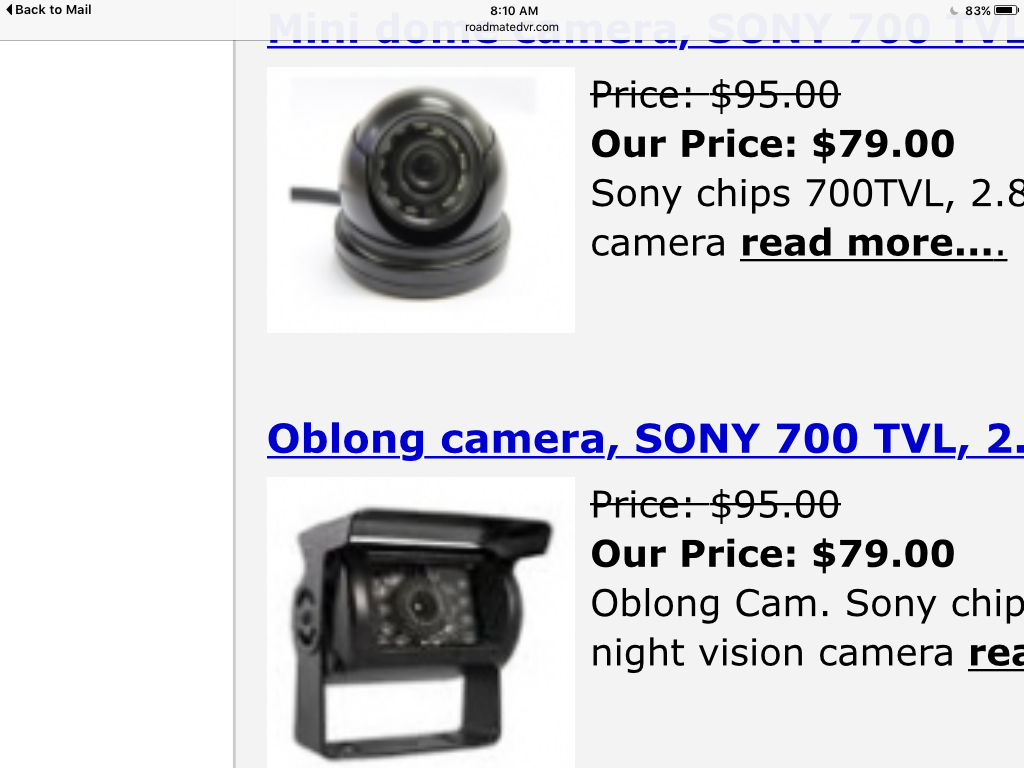

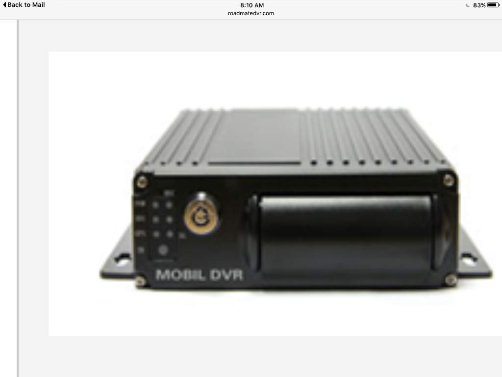

    This is the system I have. I have 4 cameras with mine and since I own my trailer I have a camera on the back of it also. It is not cheap, but their are similar systems on Amazon that are. I record 24 hours a day 7 days a week. Mine has an SD card of 32gb that saves about 7 days worth of files before it deletes the oldest. If you don’t own your truck it probably wouldn’t be a good system because it is a several hour install. BE47052D-FFE1-477F-8C72-16619AAA1C58.png 212765DC-6D9D-49AB-B188-9CFC3A1B041C.png

    All I can tell you is what is saved on my system. But I have viewd multiple days worth of footage that was saved on this card. It was resolution good enough that it appears the same as what is live on the monitor. I am not trying to sell you or anyone because I only need it to work for me. So far it has.
