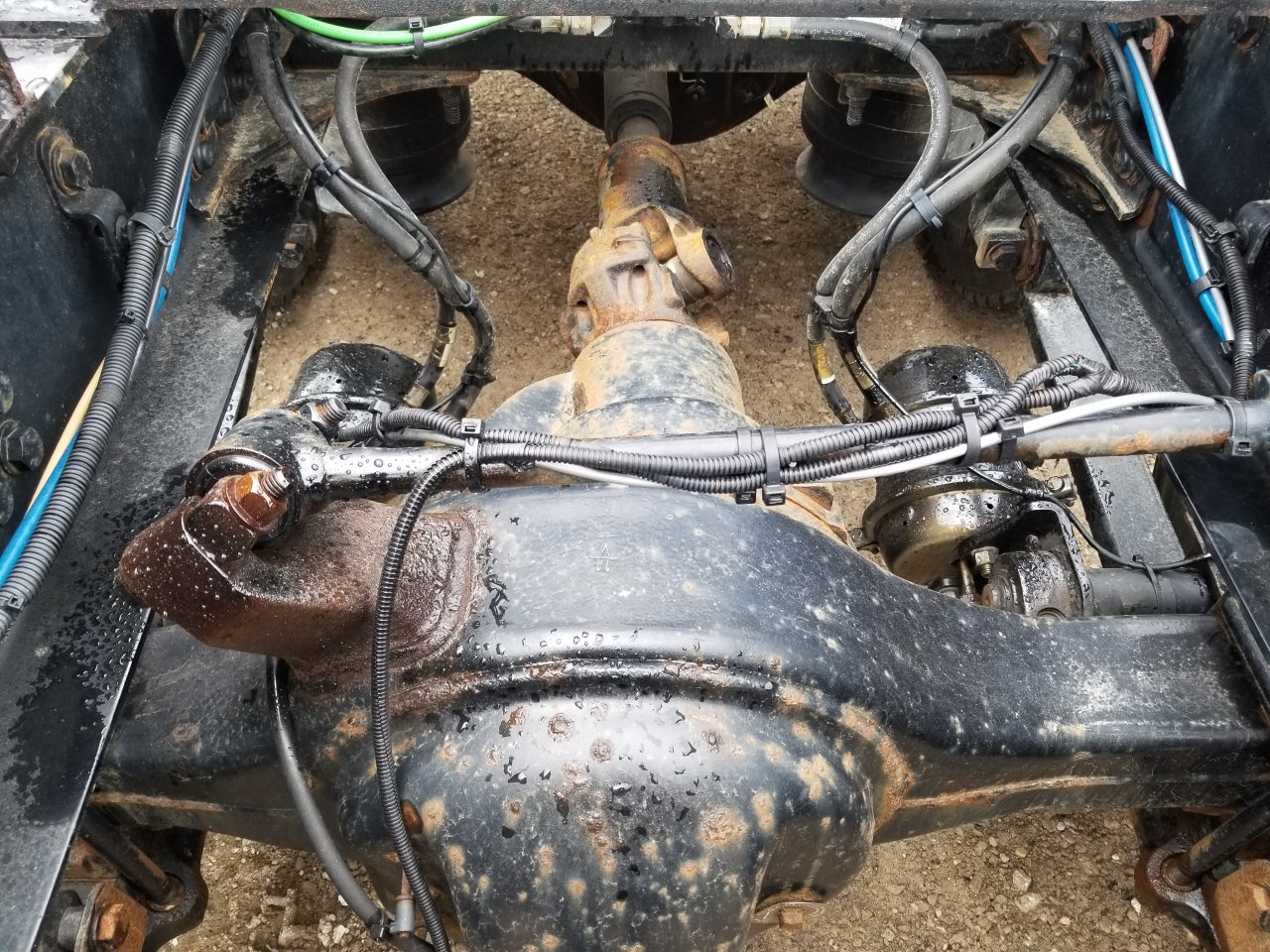

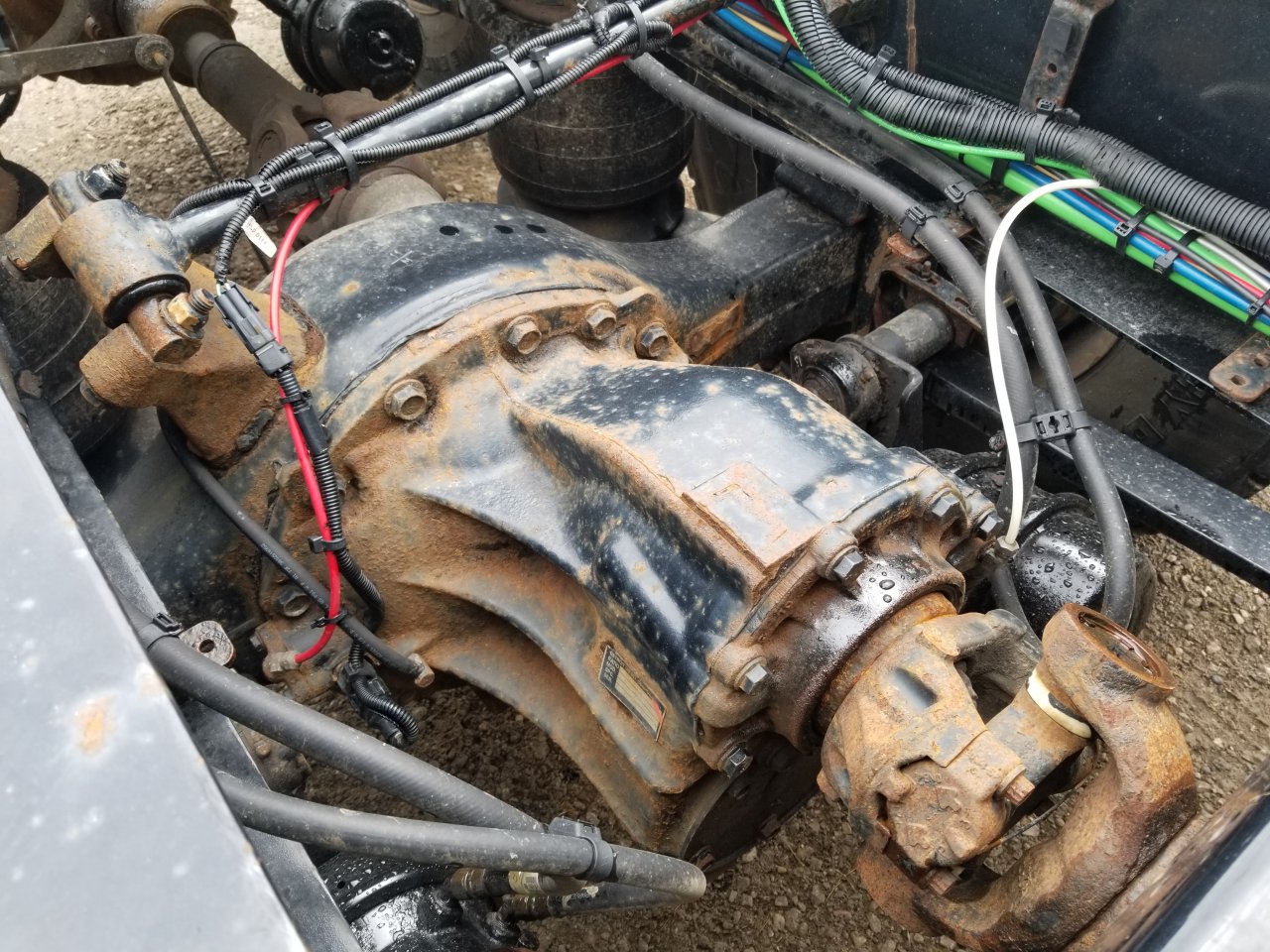

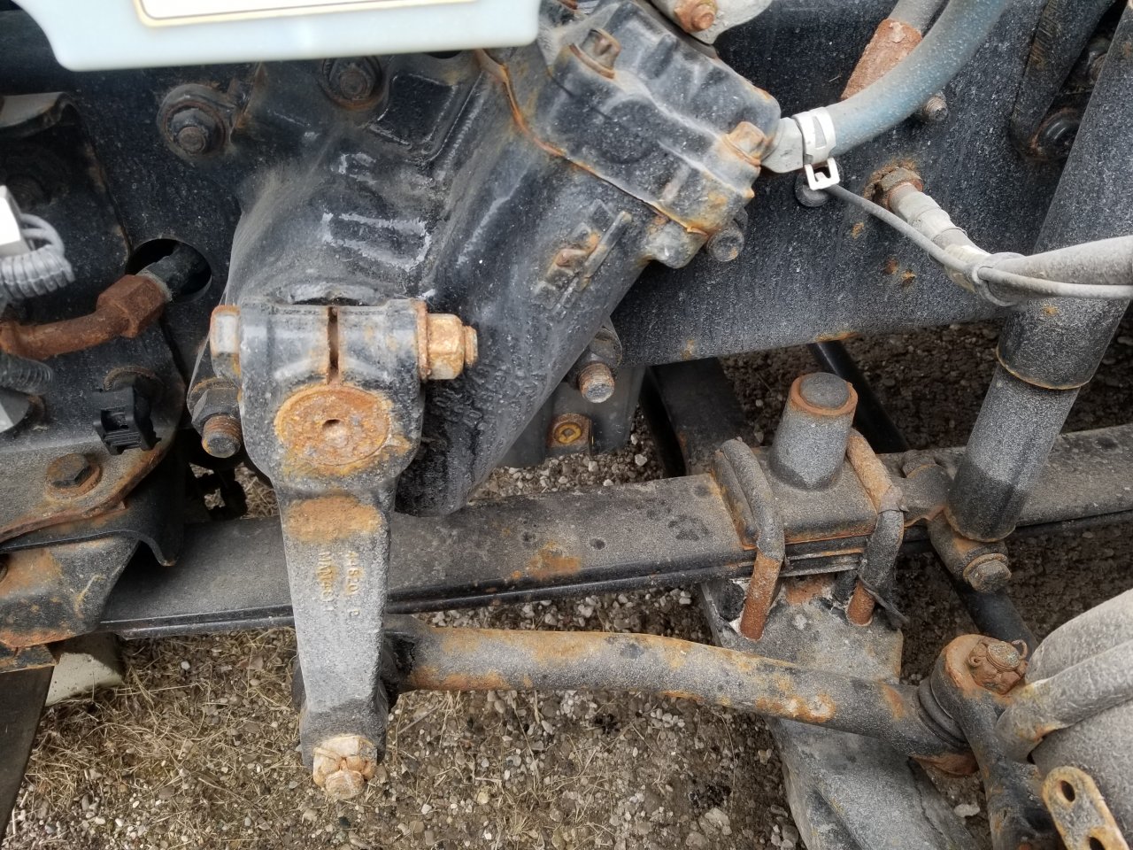

    I'm leaning towards the Western Star because of the value. The biggest cause of friction for me is the rust (I've never driven a truck with this amount and I don't know what problems it can cause in the future). I've attached a few pictures of the rust, what do you guys think?

    Looks like it’s been sittng for a while to rust like that. The frame seems good. If that’s the case. The rest is just surface rust on heavy iron, that’s not a problem.Either Truck will be a bit harder than others to get parts for, compared to Pete,kw or Freightliner. Generally speaking. Depends on where you live and run.Something to consider. I’d go with the WS if given the choice. But others will swear by the Volvo. Get the one you like

    That’s funny you mention that. My first Truck 92 WS had been wrecked and sat around, used as a yard dog. Fifth wheel wouldn’t slide it was rusted solid. Had to cut old sliders out of the rail with a grinder and cutting wheel, later found frame to be twisted.Had it fixed, otherwise a low mileage beautiful Truck. Good advice. A Truck that sits can have a slew of problems or kinks to work out, after You start running it again. Wheel seals , water pump , pitted wheel bearings , dry rotted air bags, Slimy fuel tanks. Better check that WS out good.
