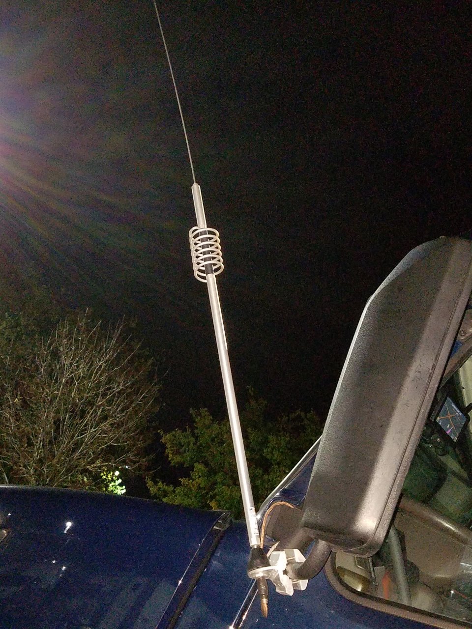

I saw this last night. It looked interesting. The driver said it reaches out 15 miles or so.
Is that bottom part being used as the ground plane? Essentially making it not need a ground
It should be grounded to the mirror arm. I didn't look too closely.
Those mirror arms are coated in a rubber/plastic unless he ground it off in that spot
