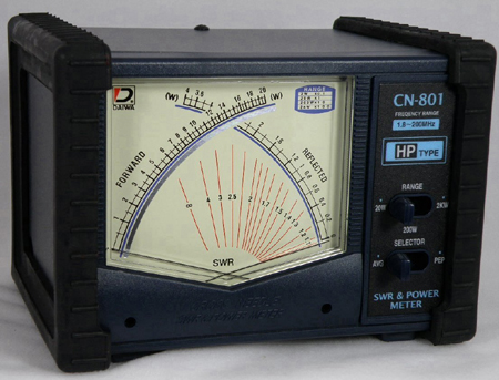

    You can't really display SWR on an oscilloscope...
    SWR (technically, VSWR; voltage standing wave ratio) as our meters show, is derived by the ratio of forward to reflected power. It's not a direct correlation, though. And yes, some SWR meters do show % reflected on the scale.
    We are dealing with impedance here, not resistance. Resistance is part of impedance; reactance (capacitive or inductive) is the other part.
    Say you have a 1/4 wave vertical antenna over a good ground plane. If the antenna is at resonance (exactly 1/4 wave long), it would have a resistance of ~37&#937;, and a reactance of 0. (That would be written as 37+j0 &#937;.) It would read on a VSWR meter as 1.5:1.
    If we then detune the antenna (either by changing the length or the frequency), the reactance would start to increase. If we get to X=37 (Z=37 +/- j37), then the shown impedance would be Z=sqrt(37^2 + 37^2) = ~52&#937;, which is pretty darn close to 50&#937;, and would barely move the needle on reflected power.
    SWR bridges are not at all related to ohmmeters. Ohmmeters measure resistance, which is independent of frequency. SWR meters measure the ratio of forward to reflected power.
    Take a look at this meter, called a "match needle" meter:
    It shows both forward and reflected power at all times. If you look at where the needles cross, the red line shows what your SWR is. This should give you some idea on how the forward and reflected power relate to SWR.
    twolane Thanks this.
