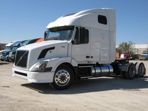

    Well as far as I'm concerned (the OP) I just want a very good mobile CB setup that transmits and receives clear and with as much range as LEGALLY possible. I run a newer Volvo Semi (not sure of the model off the top of my head) that I know has grounding issues so I will need to have my antenna grounded some way. I want to still be able to run the factory antenna mounts on the mirrors if possible while still getting a good ground.

    With side window?[​IMG]
    Without side window?
    There's basically only two body styles.

    I have driven four Volvo 670' s in the last 10 years and have never had a grounding issue with stock antenna mounts both with stock antennas and Firesticks or Wilson 2000. The swr was always good and Tx and Rx range was good, on one of the trucks I did use perch and install seperate coax,mount,and antenna only to avoid running through the Rami junction box because I was using a radio with 100 + watts.
