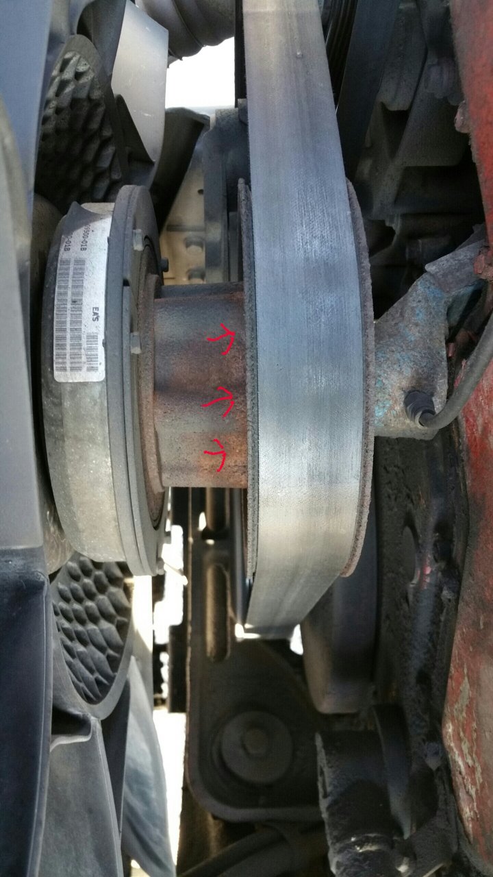

  6. mario 1156
    mario 1156 Bobtail Member
    26
    1
    Jul 15, 2010
    Miami FL
    Hi, It's a borg-warner k26 the arrows point the air leak.

    Never rebuilt one of those but I've seen them on Freightliners with 12.7's in them.
  8. GrapeApe
    GrapeApe Road Train Member
    2,215
    2,212
    Jan 7, 2013
    Generally it's not worth it to rebuild Borg-Warners, just replace it with a reman unit for about $300. Make sure to check the bearings in the pulley. IMO, it's not worth risking fan and radiator damage if they fail, so I just replace them. Bearing kits are usually $75-100 depending on the application.
