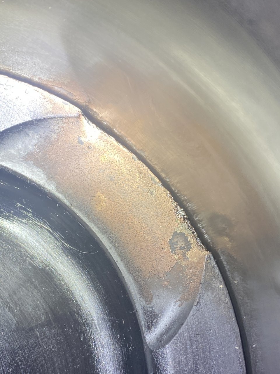

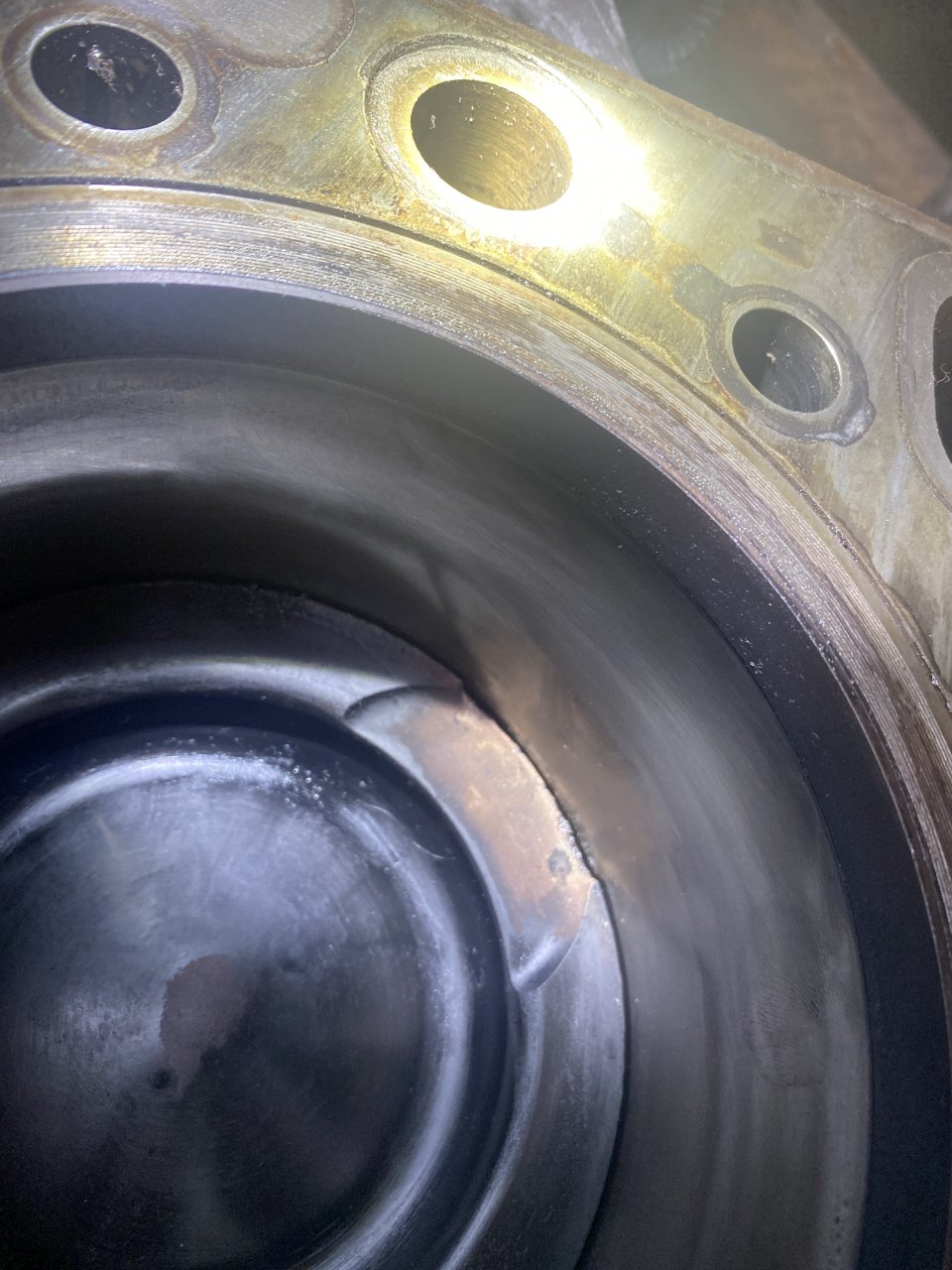

  7. JAD1024
    JAD1024 Light Load Member
    57
    21
    Apr 9, 2018
    They will be starting rebuild tomorrow - piston 1 had signs of high heat, very slight missing very small shaving off tops edging,, gasket showed leak at 1, 2, &5 liners looked good he said I might be ok with the gasket & head was up to me?? He said you don’t loose any oil and have no low oil pressure problems and I said no I do have low oil pressure a lot lately which he didn’t know before he took it apart - so with that i just decided go ahead and do the rebuild hate to have to go back later ... hope I did the right thing decided not to go the cheaper route
    Rideandrepair, Vampire and D.Tibbitt Thank this.
  8. Rideandrepair
    17,448
    56,614
    Aug 8, 2015
    . Good, better to rebuild it now, while heads off. You’re halfway there already. The time mine blew at 540k, It blew again within 3 yrs. at 825. With your mileage you’d need an inframe soon anyways. Its cheaper to just do it now. You won’t have to worry about it for years. Good Luck.
