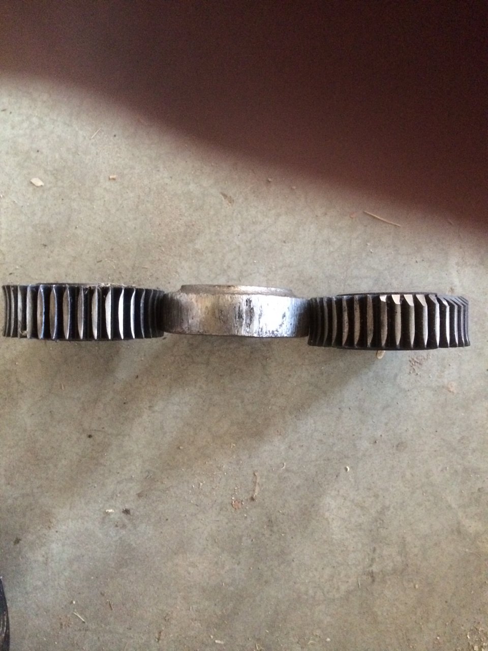

    sounds like you might have a case of this lol
    Although this sounded like a hundred niglets with hammers trying to escape
    I am sure your going to be pulling that transmission
    Depending on how many pieces were made it might be relatively cheap to fix

    My pictures were from a rt6610 road ranger
    Even if the op has a merritor there’s very little difference in design
