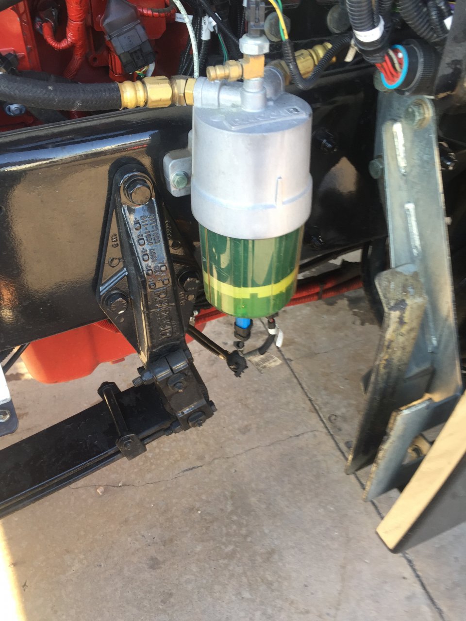

    OK but is that the filter you have?

    I think your on to something here Ridgeline. I had similar issues with an older Kenworth I had, it had an N14 Cummins, I installed a FASS filter system. With water seperator on it and it ran like new ever since.

    This is my fuel filter looks like, i get that lil filter changed inside with each oil change.

    Does this filter have that “pre filter” u talking bout?

    Yep that's it I am waiting for someone to send me the manual for that one. We had a couple trucks with that type made by rancor but because we stock Davco, I had them swapped out.
    Roberts and Wore out have it right, if it has a gauge then check it, if it doesn't, get checked.
