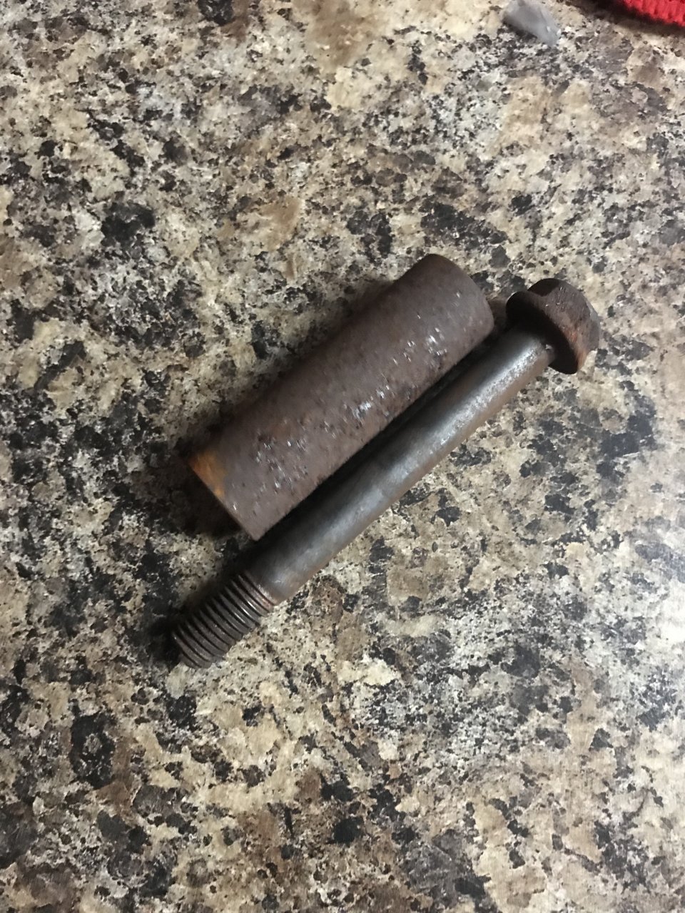

    Came back from the a shop, and they found clyinder #2 leaking oil and a big bolt was broken from the head. So now my question is do i need to rebuild motor? We havent pulled the head off cus they said we dont go inside thr motor. When i was coming back from cali to indy my truck sucked on fuel milage but power was unbelievable i was passing every other truck. Im thinking of taking it to PDI since i have the delete. But pdi also said we wouldn’t know if thr motor is due a rebuild or the head and piston needs a rebuild. And for a full rebuild they said it would be 18k

    419617C8-ED06-425A-883B-F3045AD0AE12.jpeg This was the bolt that was just broken

    Exhaust manifold bolt is what it appears to. No need for overhaul.
