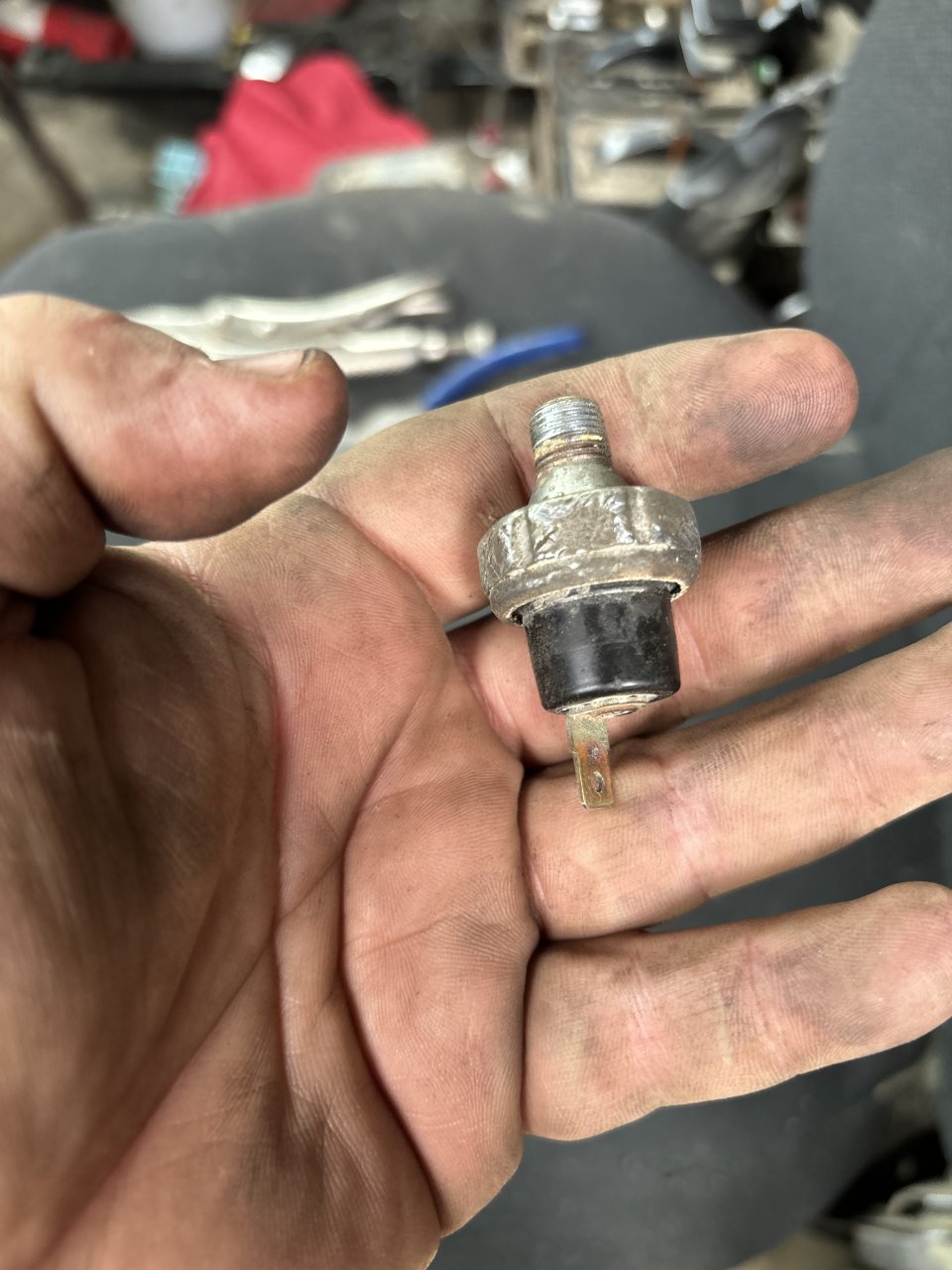

    That pic you sent, with key in on position (but not started), disconnect the wires and then short it with a paperclip or something, check around the cab if nothing changes too obviously doing that.
    Might be worth putting 12v straight t your buzzer/light to make sure they do work and its not a fuse somewhere

    Might be. Both my 99 and 2000 Classics were there, along with the brake switch ( normally open closes at 5 Lbs pressure turns brake lights on.) It’s hard to read them. Ones red ink ones green ink if that helps. If you already have the new one, you’ll see the stamp on it. Since it’s normally closed and opens at 65lbs and shuts the buzzer off. Must be stuck open. Maybe if you unplug it and jump the pigtail it will turn the buzzer on. Then you’ll know .

    I pulled apart dash and this is what I found near the green air line I’m hoping this is it?
