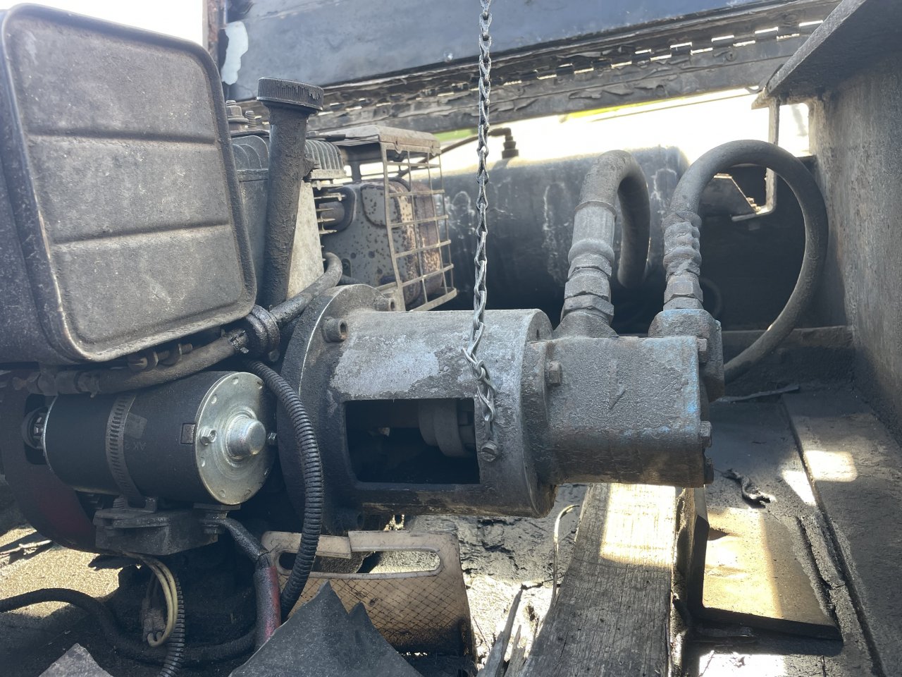

    The other question, and the most important question, is how does the pony motor connect to the hydraulics? Is there a pulley or a coupler, how does it run? What do we need to do to couple whatever engine we get to the hydraulics?

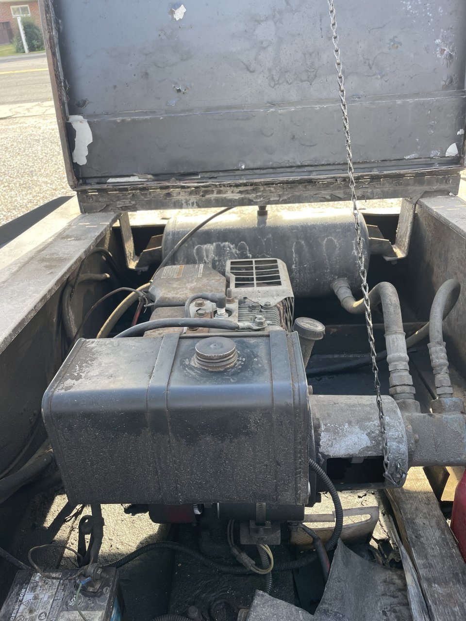

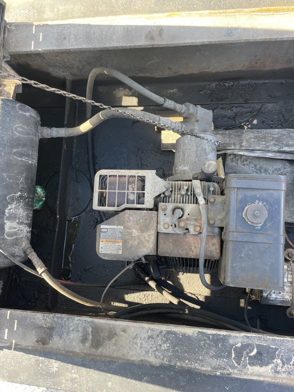

    I’ll go out in a few minutes and get you pictures of mine. It has an electric start B&S engine that does a good job….

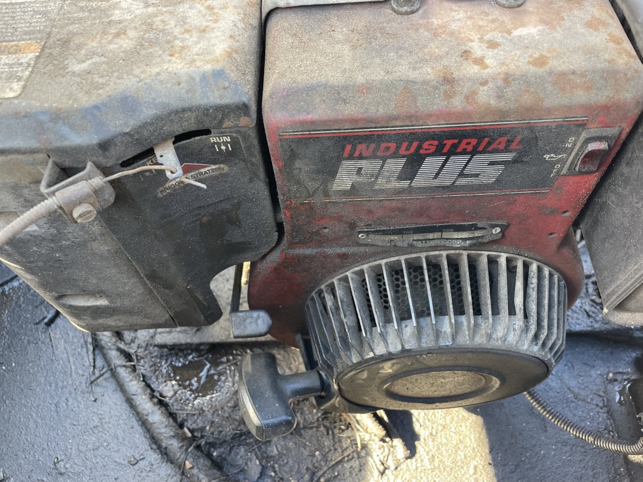

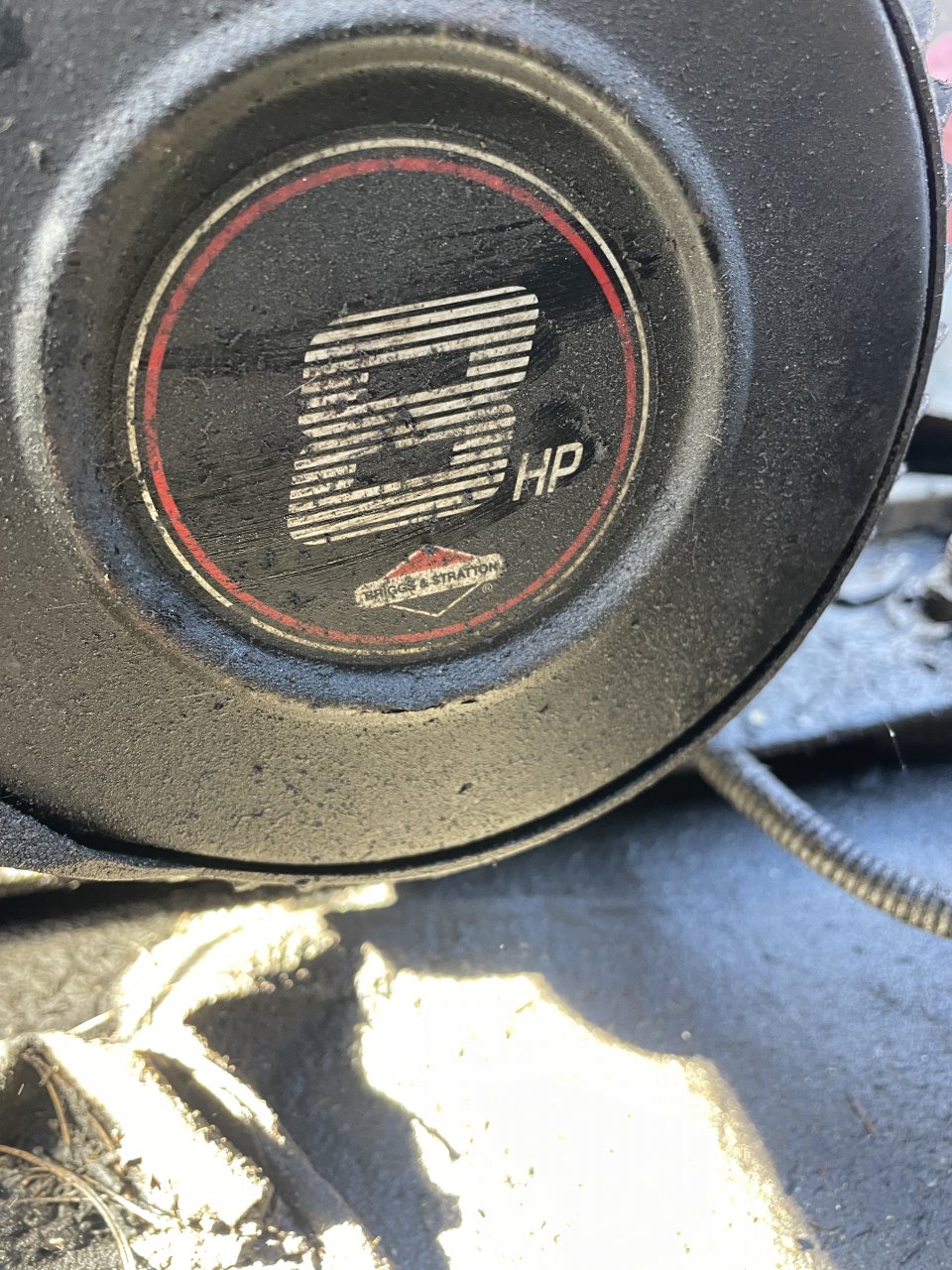

    Actually we have an older Briggs & Stratton 8 horsepower I think it's from a 60s landlord Simplicity lawn mower.
    Would that work?

    Look on the back of the block and see if it’s got the bolt holes for the adapter. May go to Harbor Freight and see if they have adapters you can measure to get an idea of what you need…..

    Here’s some ideas as to what you need….
