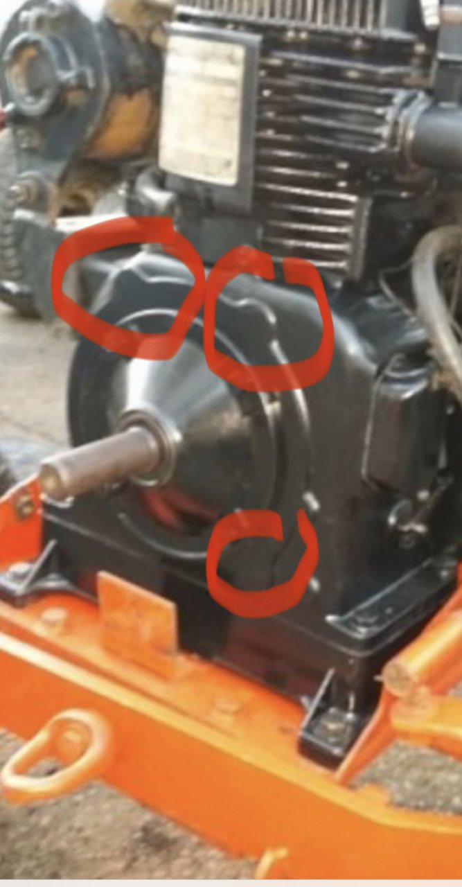

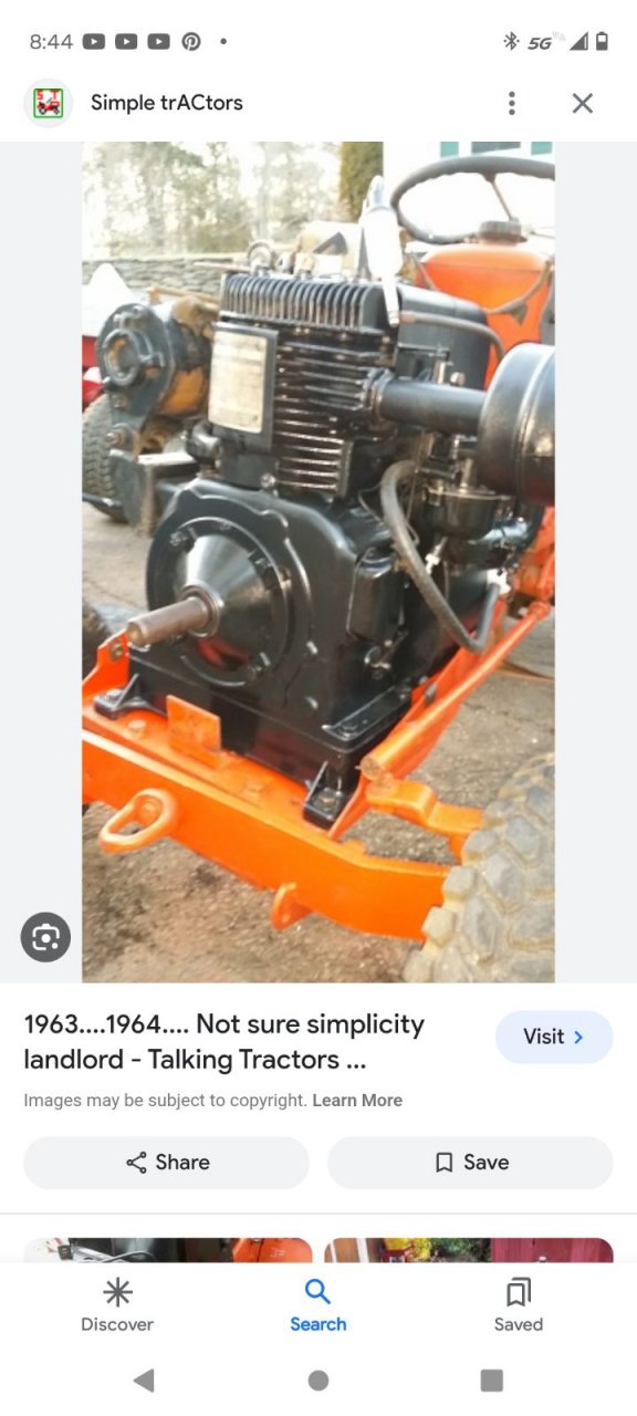

    2) we have this engine from an old Simplicity it is a nine horsepower Briggs & Stratton but apparently the shaft is only 2 and 7/8 in Long. The newer engine looks like it is 3 and 21/32 long.
    I think that conical cover has to come off the front and it looks to me like the adapter bolts on to that and removing that cover would make the shaft longer. I'm not sure what the situation is with the seal and dirt and all that type of thing if the cover is removed. As it is, it is definitely way shorter than the newer machine.
    Do you think there's a way that this engine can work to run that pump? I believe it does have the same 1 inch shaft and quarter inch keyway.

    (1). My engine was a replacement that was installed when the trailer still belonged to EZ. I started pulling this lowboy for them in 2005. It was already drilled and tapped for the adapter.
    (2). Not sure you’ll have much success since it’s not drilled for an adapter. You would have to get the adapter to fit that pattern, then get it lined up as close to perfect as you can. Pull the back section of the block off and drill and tap it off the engine.
    The Joy couplings as we always called them will allow for a little out of center but it’s minimal, very minimal.
    Sometimes it takes some doing to get it all together, that’s why I mentioned one the little Case Ingersoll tractors. You get the engine, adapter, and hydraulic pump already bolted together, mount it, hook 2 hoses up, and go to work…

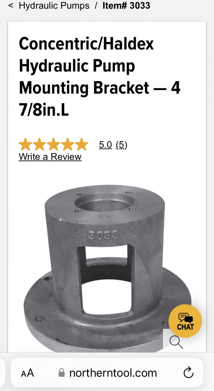

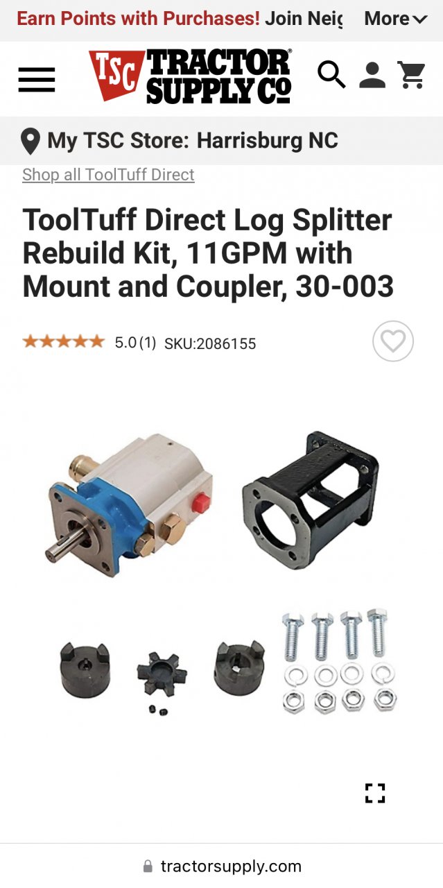

    Well it turns out we're going to need the pump and the coupler along with the engine.
    I just wanted to make certain that the pump pictured above is the correct pump/ gph, etc to run the lowbed.
    Also will that pump and adapter fit the Honda GX390, I think we found one of them.
    If so, we'll get it right away.
