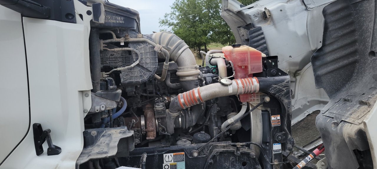

    I have a 2019 T680 with the same problem. I hacked a solution to the problem with a magnet and 2022 version of baling wire. All alarm lights and sounds are off and truck runs fine. Just do your precheck and eyeball the antifreeze reservoir, keep an eye on your engine temperature gauge and use your nose to sniff out any antifreeze odor. You don't need no stinking low coolant sensor. Pics are attached.
    fireguygary Thanks this.
