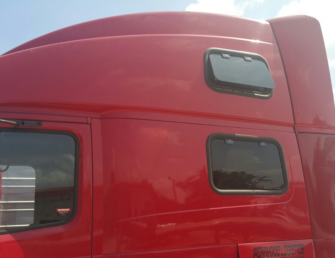

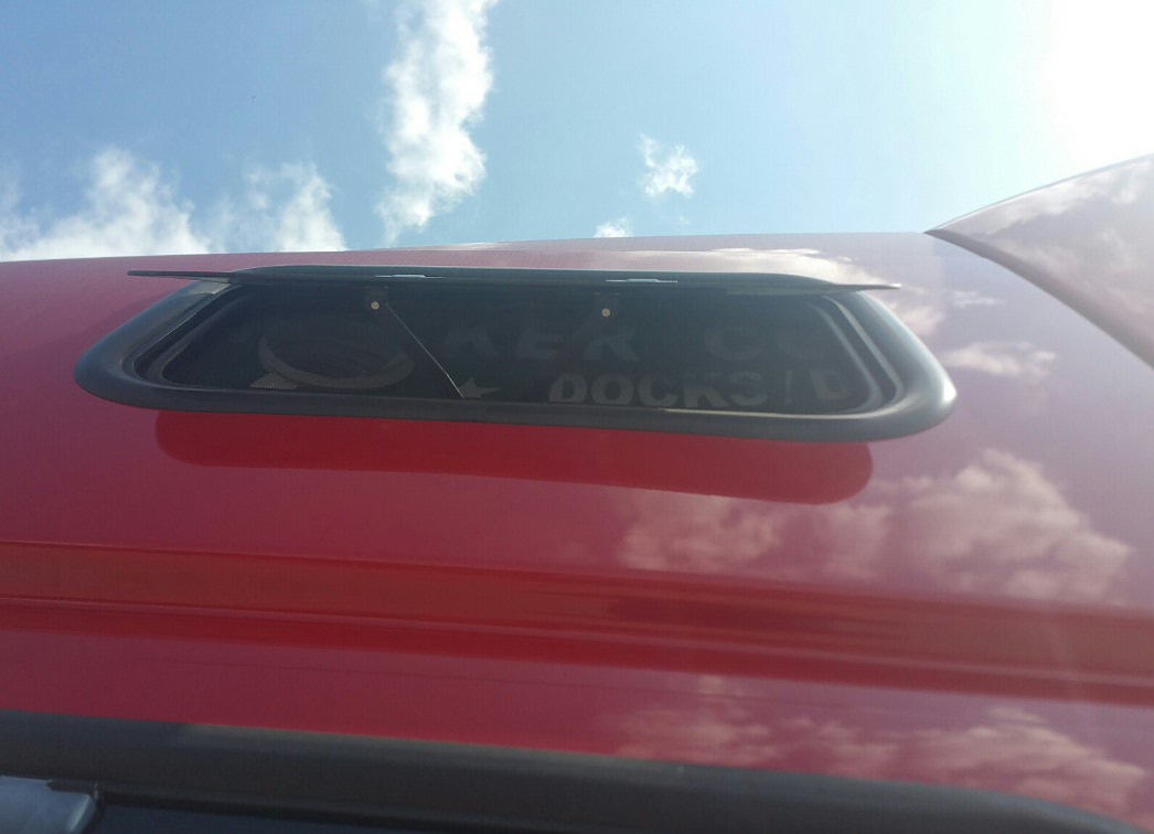

    I mounted the portable ac unit on top bunk and made a window blockoff out of a plastic 2 layer sign to seal it off. I removed window trim to install the window block and insulated it before reinstalling the trim once the hose was in place. This has it out of the the way and top bunk is still usable for sleeping. When not using the ac/ i can just shut the window.
    I sleep up top and leave the table setup downstairs.
    I had switched the 10btu out for 8btu and it cooled the truck interior from 95 to 75 inTampa Florida sun so i imagine it will be fine most nights. I just woke from a nice hr long nap and ac did great plugged into the house.
    3100 champion inverter generator with remote start and 30hr extended run time 6 gallon tank will arrive tomorrow.
    Thanks for the suggestions and advice.

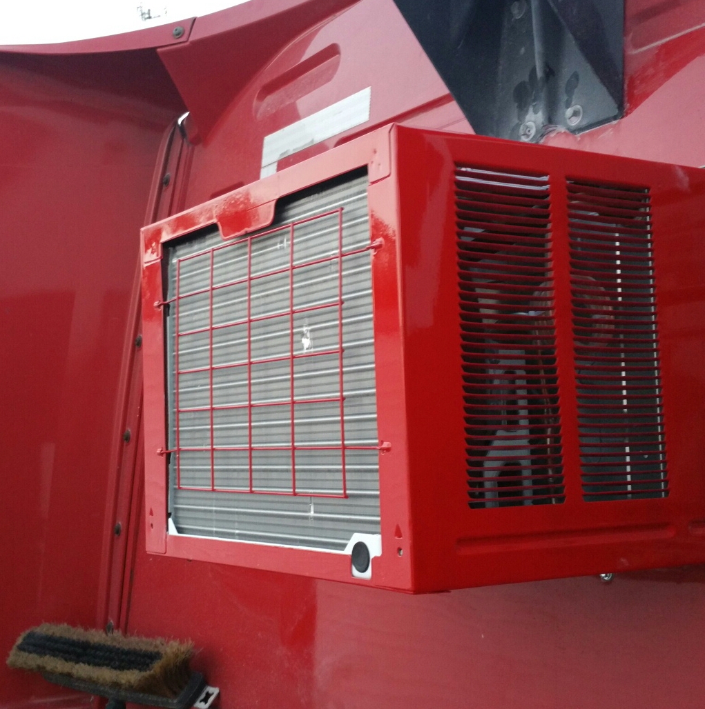

    I understand your concern but putting generator behind trailer seems excessive. I mounted the generator on the tractor and have an 8ft pipe that runs exhaust away from the cab.
    I ended up taking the portable ac back and getting a more efficient window unit and mounted to back of cab.
