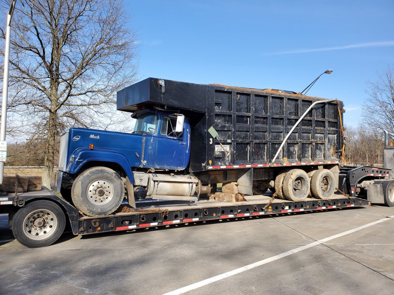

    This is a broke in half dump truck I moved last year. That trailer has a 36 foot well and I think the deck height is like 18 inch. But that's a long three axle lowboy but with the pin-on removed it's manageable.

    That looks like you needed that whole 36-foot well.
    I would consider buying a 3-axle if I could put it to work, but my truck is not a Heavy Haul truck and my experience really is just mainly hauling regular construction equipment not oversized on a low bed.
    Two axle lowbeds don't have a well that long do they?
