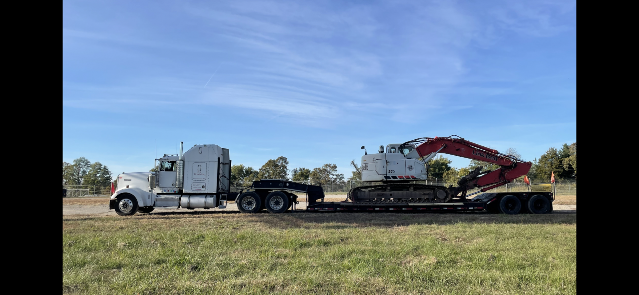

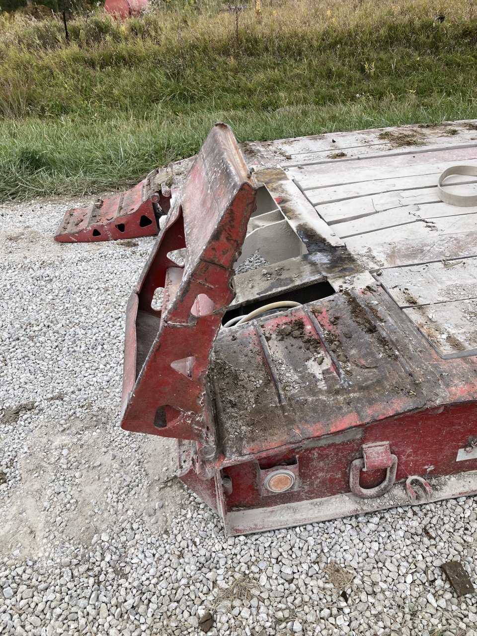

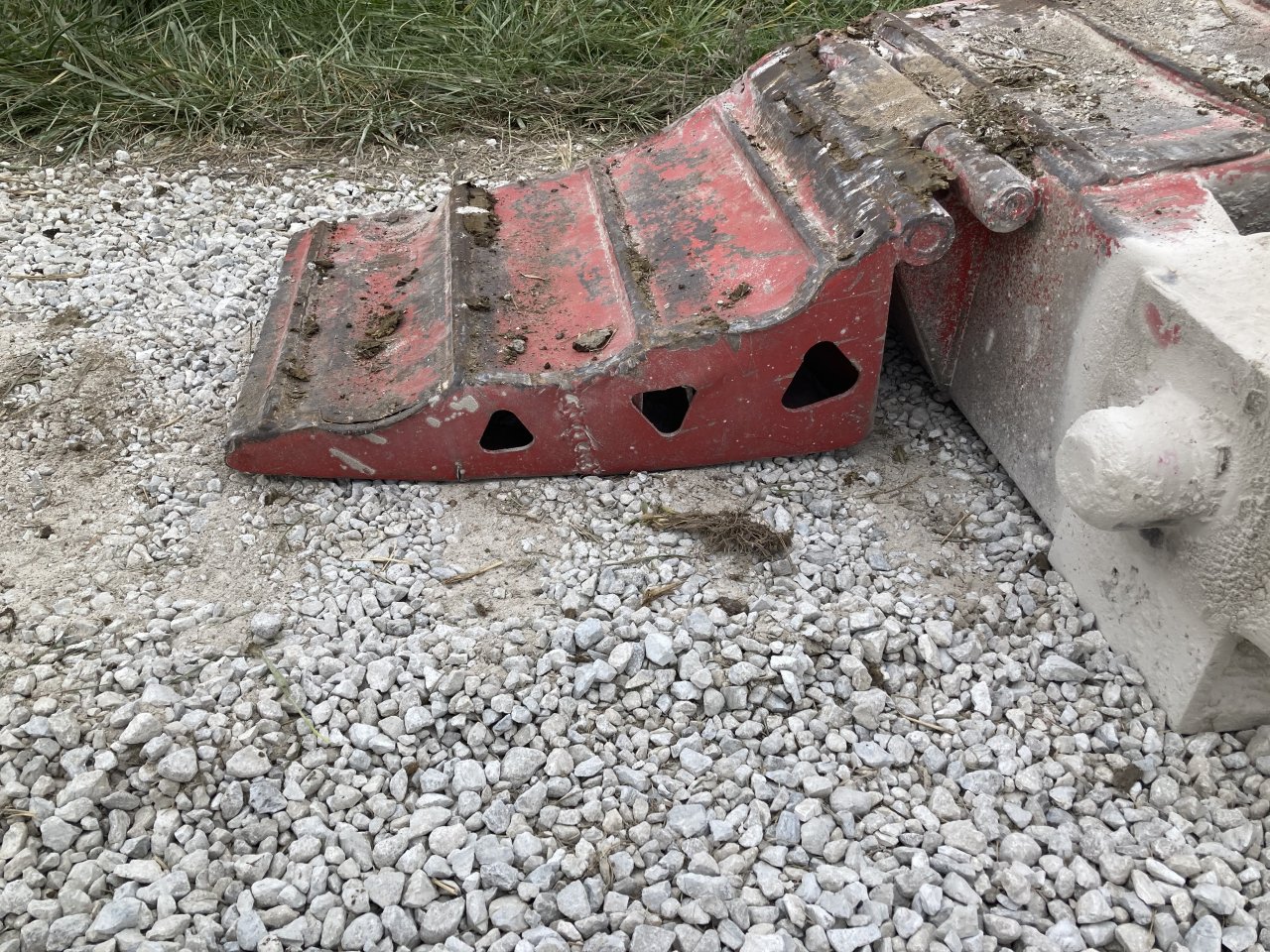

    5E95F8C0-6B02-4DD3-A7CA-60B9D9AD950B.jpeg 02CBAB0F-42E4-4195-99A2-D6EF7C36C627.jpeg 0F1B1D18-773D-47ED-B10D-21C4E450E0B3.jpeg
    that don’t look like this
    I was just looking for other ideas to copy
    I don’t have a problem with these but there becoming unusable
    Maybe I just need to make new ones out of heavier material or maybe a different design
    Just looking for opinions

    Make new ones for sure.
    Longer for less steep angle would be nice to.

    Recomend using at least 3/8 plate on the new ones. If not available just Double up the 1/4 plate. Put in some angle reinforcements on the sides to help stop the stress cracking.
    I know that stuff gets heavy but the ramps are always made too weak to begin with.

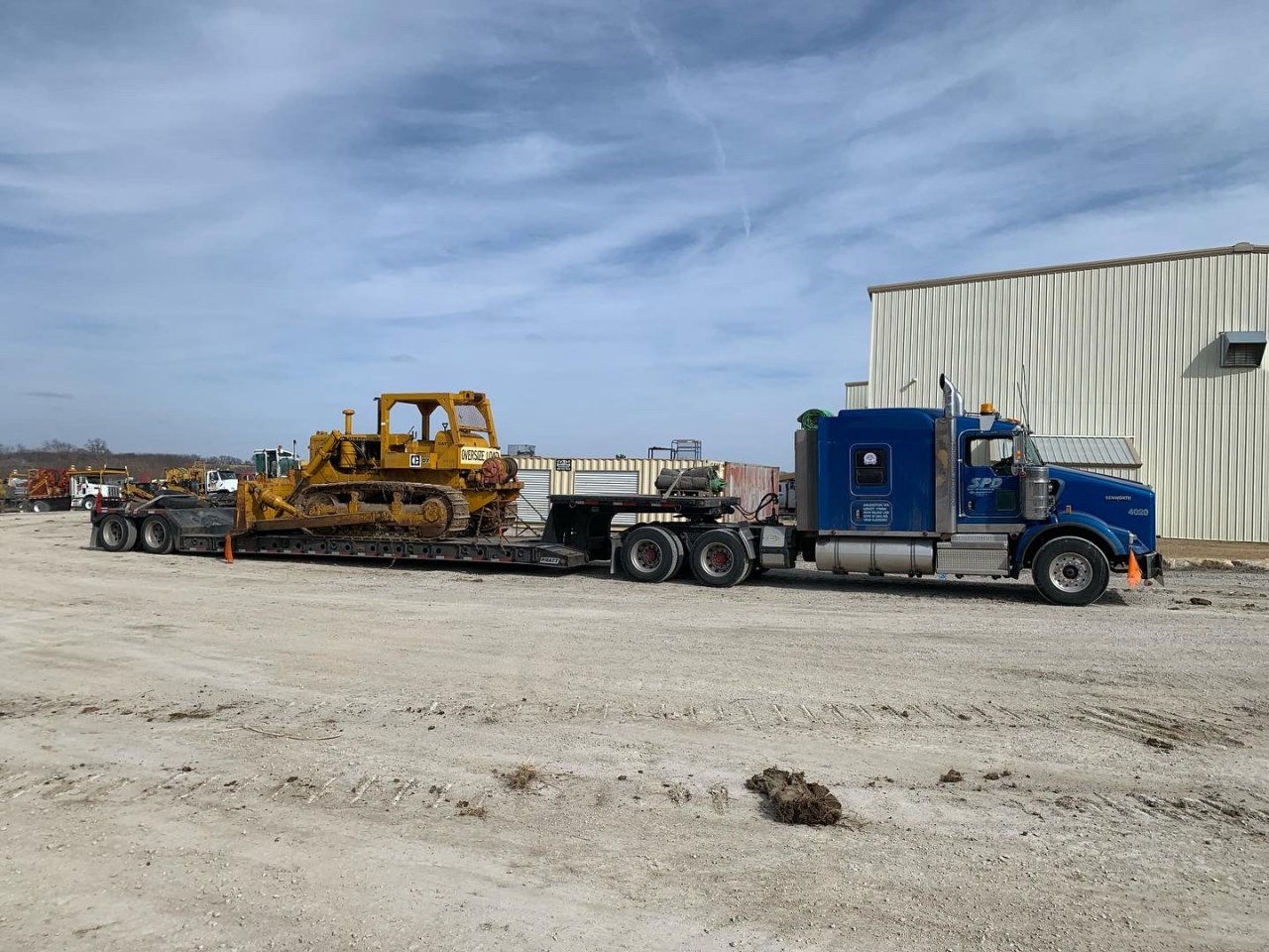

    Do you need ramps if your not hauling smaller equipment? I’ve had trouble with smaller skid steers on this trailer but never tracked equipment. Granted I’m not hauling multiple pieces per day. D802DFA5-84A1-42F5-86CE-AA82943D0E1C.jpeg 36568A2A-3BC2-4C5A-B189-DD029BC87621.jpeg

    I probably don’t need ramps. I think I have only had 2 skidsteers on that trailer and most of the tractors I have hauled wouldn’t need ramps but I feel like it’s going to trash the front of the trailer especially with dozers because if they slip at all it’s going to try to tear that front corner off. Is there much wear on yours.
    My trailer also has a very thick deck so it about 10 inches high without ramps. I was thinking about adding on to the front of the trailer with a fixed ramp to maybe get down to 4-6 inches and call it good.

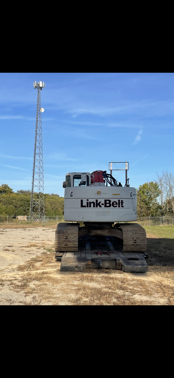

  9. OLDSKOOLERnWV
    19,711
    298,113

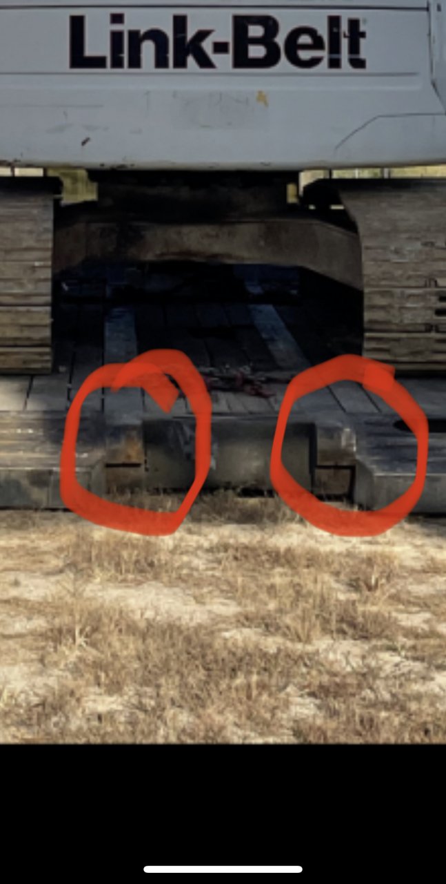

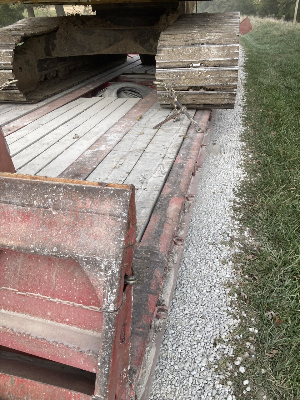

    I have ramps but actually don’t use them much. I have more problems with smaller dozers wrecking the front of the trailer.
    I’ve been pulling this same lowboy since 2004 when EZ owned it.
    Never had much damage till lately allowing others to load the equipment….
    9AB28FF0-C2F7-416E-A92B-D1EAF695EF37.png A17750D6-A14E-4749-A4D2-CAB3AD5ACE98.png
    lynchy, cke, singlescrewshaker and 4 others Thank this.

    Are the small dozers breaking boards because they run between the frame rails?
    Does that trailer belly down or just the picture?
  11. OLDSKOOLERnWV
    19,711
    298,113
    The narrow gauge dozers scar the upper locks. Not so bad if they just crawl on and straighten it after it’s on the deck, but the horse heads will steer it going over the locks and chew them up.
    I try to always load my own trailer, just some cowboys with out a clue are trying to load before you get the tractor parked.
    I have 2 direct customers that know how to load, others are terrible at times.
    Yea when it’s got 50,000+ on like in this pic it looks slightly sow bellied. Don’t have much arch anymore. I’ve had 68,000 on the old girl and she handled it like a champ…..
